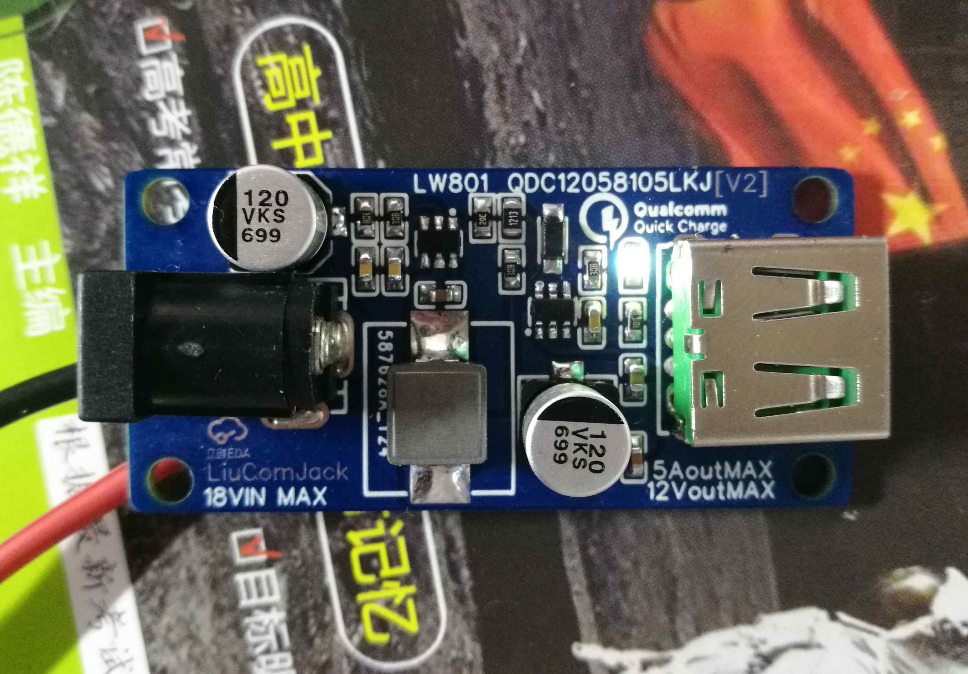

Input voltage: 6-18V (try to be greater than 13V)
Output voltage: 5-12V adaptive
Output current: 5A maximum
supporting agreement:
QC3.0 Class A, QC2.0 Class A
Huawei FCP fast charging 5V and 9V voltage configuration
Samsung AFC fast charging 5V and 9V voltage configuration
Spreadtrum SFCP fast charging 5V, 9V and 12V voltage configurations
Apple 2.4A, Samsung 2.0A, BC1.2
Very low internal resistance of the power tube: (top/bottom): 40mΩ/26mΩ
Ripple can be as low as 20MV (data sheet test form, 5V5A output)
Power indicator light, changes in brightness can indirectly reflect changes in output voltage
For detailed information about the chips used in this module, please visit the attachment for more information!
If you guys find my project helpful, please give it a thumbs up and like it!
The working current of the mobile phone when the power is 70%, the fast charge trigger fails, the reason has been identified and fixed in the engineering document: DMDP is reversed.
As for the circuit, we will test it until all the functions are properly exerted. Please look forward to the test data of the new PCB!
