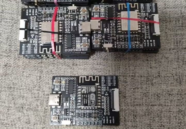

I. [Product Overview]
This product is a universal ESP8266 driver board for 24-pin electronic ink screens, which can realize the driving function of 1.54-inch, 2.04-inch, 2.13-
inch, 2.6-inch, 2.7-inch, 2.9-inch, 3.71-inch, 4.2-inch, 5.83-inch and 7.5-inch black and white screens and three-
color screens. It can drive various 24-pin SPI interface electronic ink screen bare screens launched by manufacturers such as Weixue and Jiaxian. The board is equipped with ESP-12F module (ESP8266 finished module) and supports Arduino development. The hardware pin definition uses the same definition as the Weixue driver board and related program routines, and can be directly tested and developed using the related local routines and WIFI routines provided by Weixue;
Top layer:
Bottom layer:
Overall effect diagram:
2. [Design description]
In this project, in terms of circuit design, the reference circuits in the User Guide of the ink screen using the Jinghong (UC***) series IC solution and the Solomon (SSD***) series IC solution are used as references. For subtle differences, a compatible design is adopted, which can be compatible with most of the ink screen products with 24Pin interfaces on the market.
At the same time, considering the requirements of low cost and easy production, the devices are all packaged in a size not less than 0603, which is convenient for manual welding. All devices are located on the top layer of the PCB, which is convenient for welding using a heating table; for some devices with specific parameter requirements, a variety of alternative models are provided for selection.
For users who need miniaturization, customization and re-layout, derivative design and secondary development tips are provided, see the subsequent chapters for details;

V. [Test point description]
This adapter board has test points for measurement. The test points include PREVGH, PREVGL, VCOM, RESE, GDR, and GND. The functions of each test point are as follows:
1) GDR: N-MOS (SI1304BDL/SI1308EDL drive signal test point).
2) RESE: boost circuit feedback current test point.
3) PREVGH: boost circuit positive high voltage test point.
4) PREVGL: boost circuit negative high voltage test point.
5) GND: power supply negative pole (test point voltage common end).
6) VCOM: Test point for the common voltage of the electronic paper.
