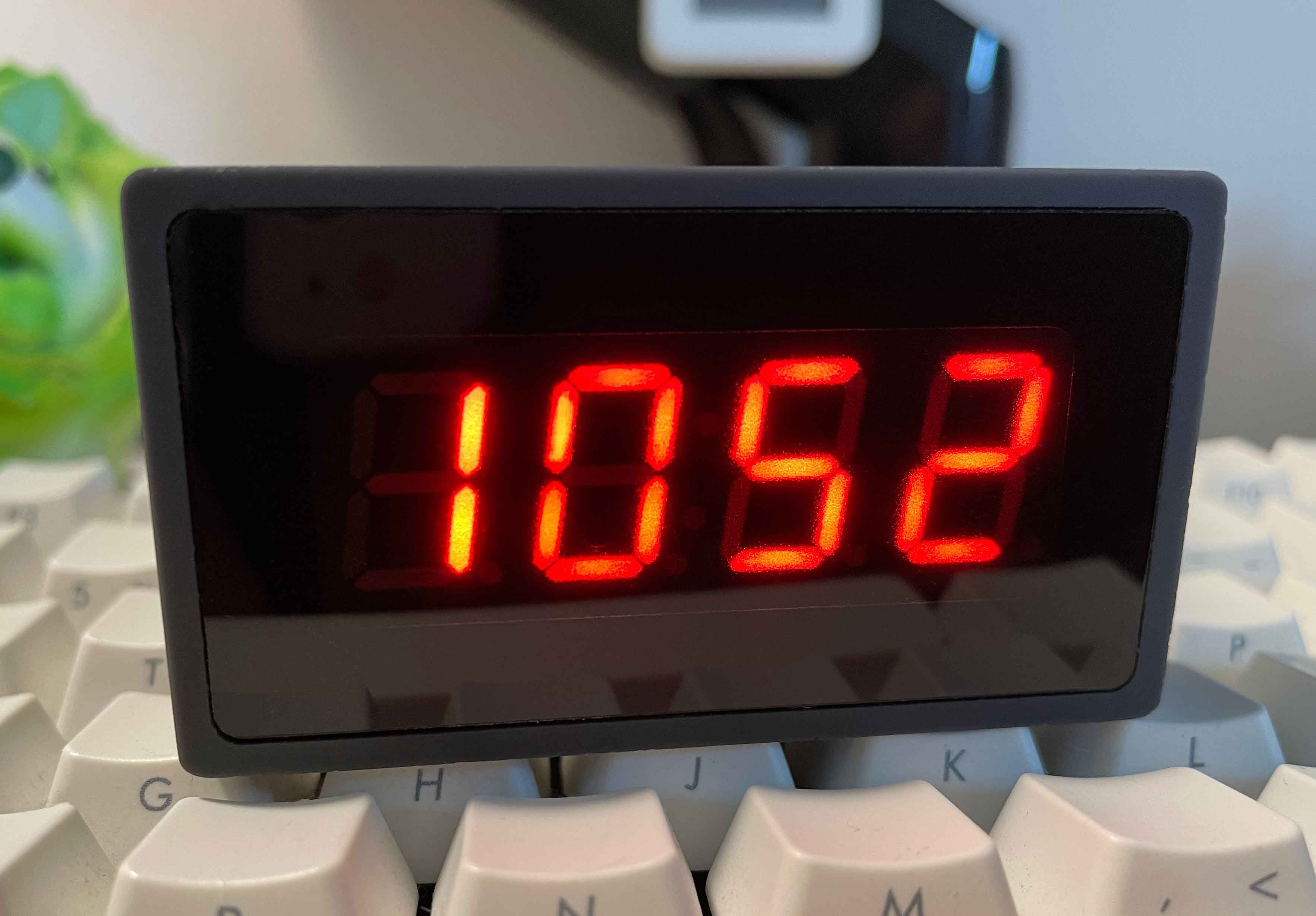

6. 3D Shell Preview
1. The 3D shells are all printed with 3D Monkey's Black-photosensitive resin material, with good molding effect and uniform black appearance.
6-1_3D Shell Preview Figure
7. Actual Preview Figure
7-1 Actual Front Preview Figure
7-2 Actual Back Preview Figure
7-3 Actual Time Display Preview Figure
7-4 Actual Temperature Display Preview Figure
7-5 Actual Humidity Display Preview Figure
