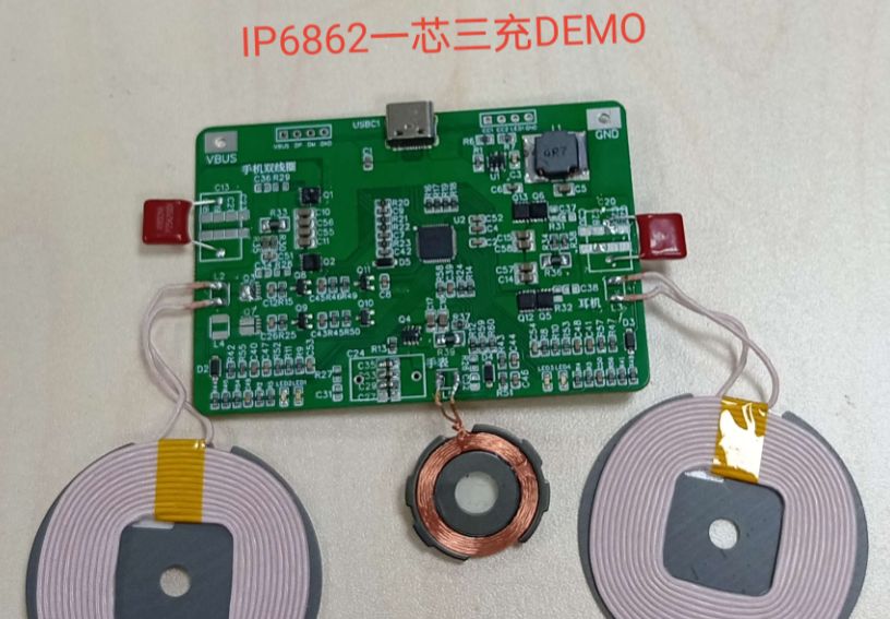

IP6862, one to three
IP6862 is a wireless charging transmitter control SOC chip that supports one-core multi-charge. It integrates 32-bit MCU, ADC,
Timer, I2C, H-bridge driver, ASK demodulation & decoding and rich IO resources. It can customize various Qi Protocol wireless charging solution and passed certification testing. IP6862 integrates multiple charging head fast charging protocols and supports high-voltage wireless fast charging. IP6862 integrates rich IO resources and supports customization of indicator light effects. Users can also customize indicator lights through the PC host computer.
● Supports the latest WPC standard
 Supports Qi protocol BPP, EPP certification
● Working voltage
 4V ~ 20V
● Supports single channel maximum 30W applications
● Supports a variety of one-core multi-charge topologies
 15W + 15W
 15W + 15W + 3W
 Power down Compatible
● Integrated 2 sets of H-bridge drivers
One set of 4N H-bridge drivers
One set of 2P2N H-bridge drivers
● Integrated internal voltage & current demodulation
3-way voltage ASK demodulation
2-way current ASK demodulation
● Support low power consumption mode
● Support FOD foreign object detection function
Static FOD detection  Dynamic FOD detection
● Support external passive crystal oscillator
● Support X7R/CBB/NPO capacitor
● Support Q value detection
● Dynamic power
adjustment )
● Input overvoltage, overcurrent, undervoltage, NTC over-temperature protection functions
● Integrated large-capacity MTP, supports repeated firmware upgrades
● Supports PD3.0, and multiple DP&DM fast charging protocols
● Package 6 mm × 6mm 0.4pitch QFN48
