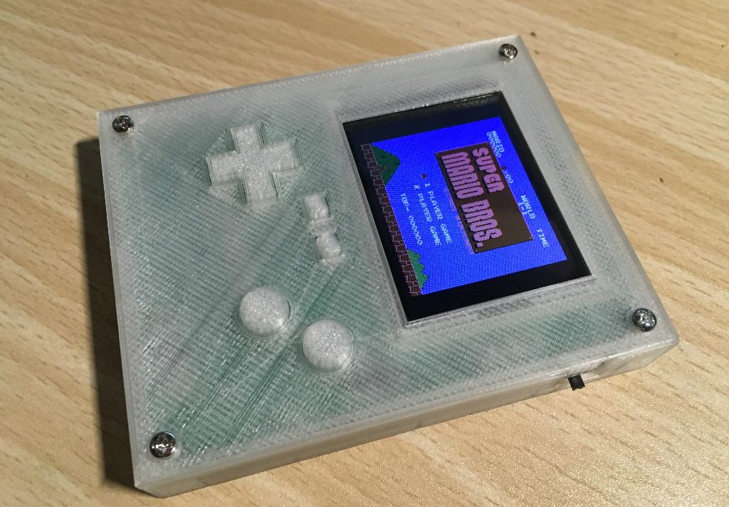

An open source game handheld based on ESP32, which can run standard NES (Japanese version is FC) games and supports mono audio. Let you reminisce about your childhood at any time.

characteristic
  • Low cost: Only one ESP32-WROOM-32 module implements all functions without external Flash, SRAM and DAC.
  • Easy to make: The RC components are packaged in 0805 and are easy to weld. The tolerance issues of low-end 3D printers have been taken into account when producing the 3D file of the shell, which improves the success rate of shell production.
  • Good compatibility: Most NES games tested can run perfectly
  • Conveniently download games: Games can be downloaded without recompiling the source code. The built-in ESP32 automatic download circuit eliminates the need for manual reset during downloading.
  • Built-in battery: Built-in lithium battery charging circuit and low battery indicator circuit.
  • Low power consumption: The 400mAh battery can last for about 3 hours.
  • Multi-function: All available IOs of ESP32 are introduced on the board and can be used as an ESP32 development board.
  • Three indicator lights: red: low battery; blue: charging; green: battery full.

Use a third-party 3D printing service or print the shell yourself. The model file of the shell is in the attachment. image.png

16. Turn on the power switch. If there is no abnormality, the "TANK" game screen should appear. If the screen is white or the screen is not bright. Please recheck the welding and downloading from the first step after disconnecting the battery. image.png
17. Use a 2.5mm diameter drill bit to expand the screw hole. If you do not have the relevant tools, you can also use self-tapping screws. image.png
18. Tear off the LCD screen protective film (follow your own habits, you don’t have to tear it off if you don’t want to). Use the double-sided tape that comes with the LCD screen or glue it yourself to fix the screen (be sure not to fix it crookedly!), put the PCB into the bottom case, place the buttons, cover the top case, and tighten the screws. image.png
19. Done, let’s start playing~
