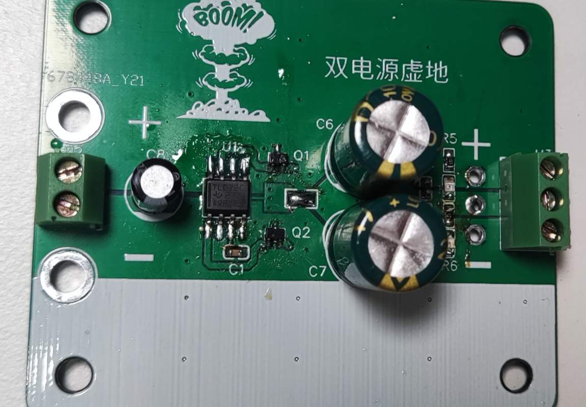

Virtual ground dual power supply
Circuit source [P02] Enjoy The 47: Optimized version of the 47 headphone amplifier, full data download - Zhihu (zhihu.com)
Recommended current limiting resistor values
​​Single power supply voltage (V)
Quiescent current (≈mA)
Current limiting resistor (Ω)
Resistor power (W)
0.04
23
0.08
240
0.1
18 (not recommended)
330
0.132
24 (not recommended)
470
0.188
No-load tested, load not tested
