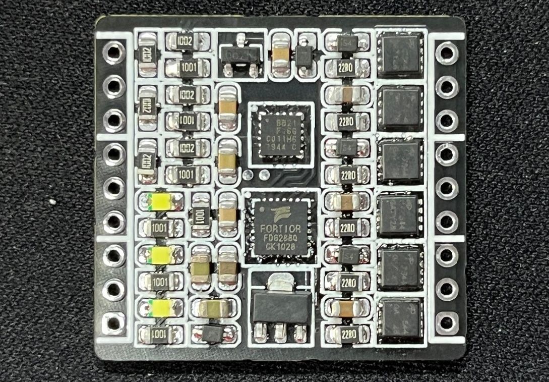

[Schrödinger’s Rabbit Paper] ESC based on EFM8 microcontroller
! ! ! This board does not have a bus filter capacitor. Be sure to add an electrolytic capacitor when using it, otherwise the tube will explode! ! !
This solution comes from https://oshwhub.com/CLZ1/ji-yublheli-diesc.
Using the open source BLHeli firmware
ESC principle and firmware flashing method, you can refer to the above project.
I drew the PCB with the following three purposes:
1. [Be cute and cute] [Guotian]: It means that the size of the PCB should be as small as possible
2. [Obsessive-compulsive disorder friendly]: Align and align! If not aligned, you will die!
3. [The Stubbornness of 0805]: I am blind and only solder devices above 0805 (the
design goal is to make a small-sized, low-power 12V ESC with single-sided components
and finally achieve a PCB area of ​​26*28mm. If it is opened in half holes, and remove the upper and lower redundancy, it can be reduced to 25*25mm, which is suitable for the module to be attached to other PCBs. For
PCB project files, please see the attached
circuit diagram to preview
the front and back of the PCB, and to preview
the real shots of the front and back of the PCB (without adding bus capacitors)
. Actual use effect:
