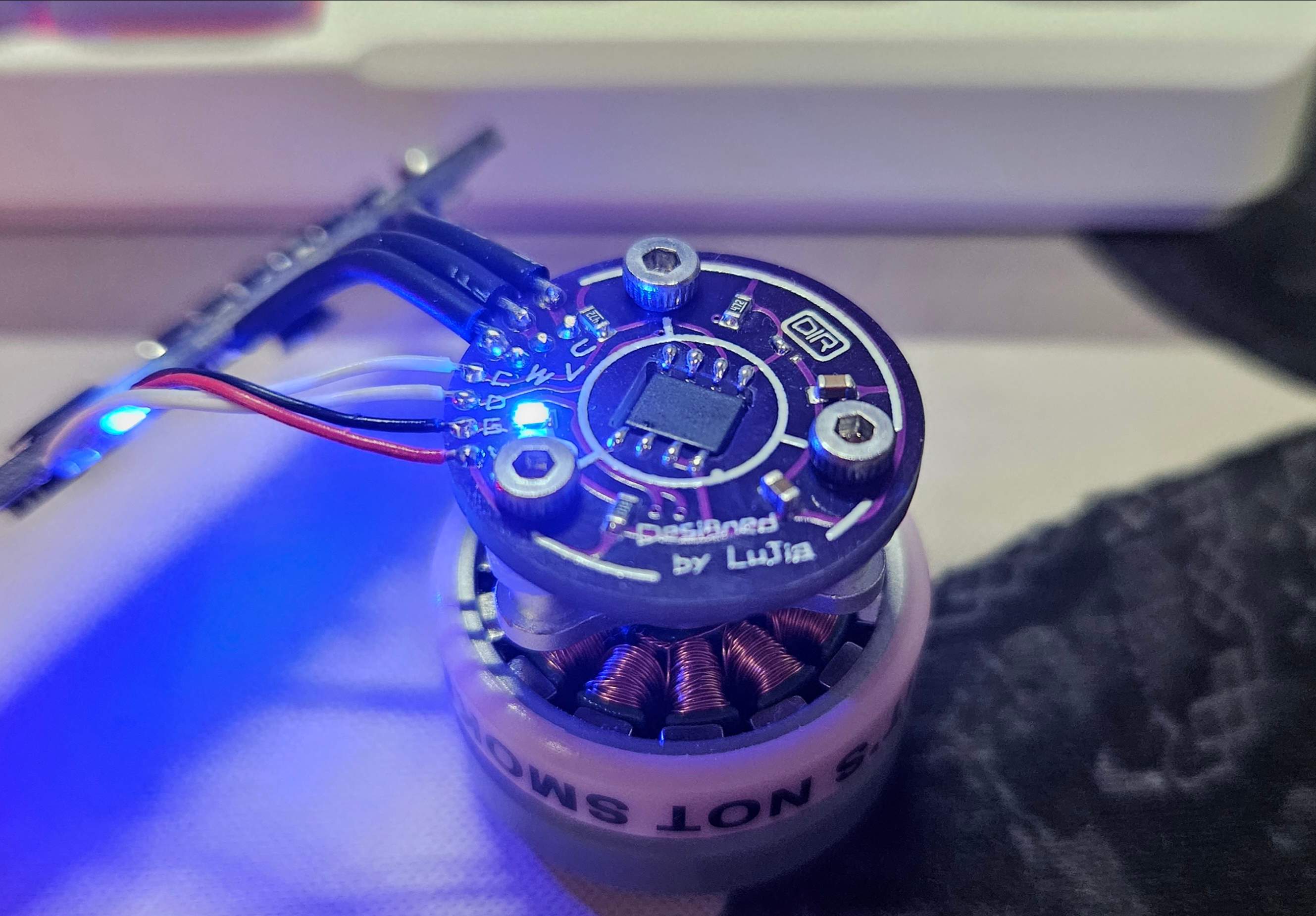

AS5600
    1. 3.3V power supply.
2. The sensor is attached to the sinking plate.
3. Only supports IIC mode output.
4. Suitable for motors with three mounting holes evenly distributed on a circle with a diameter of 16.
5. The attached board making file is made by using a plug-in to smooth the wiring and add teardrops.
6. The outlet wire needs to be welded directly.
7. The function has been verified to be ok. Please note that the size of the middle opening is too small and the chip pins need to be bent inward to insert them.
