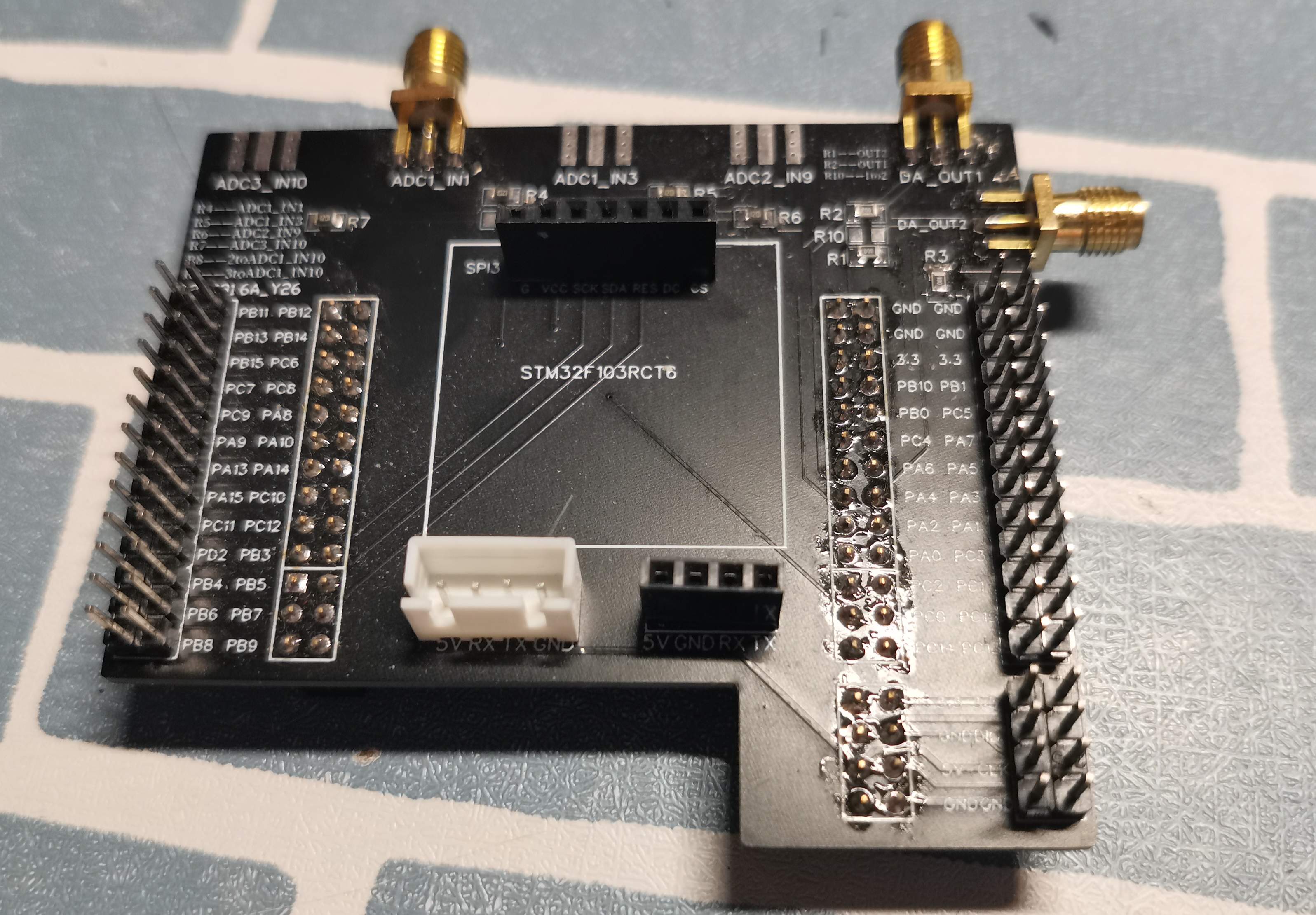

stm32f103RCT6 adapter board
DA: If 2 DA ports are used alone, weld R1 and R2
ADC: Each ADC port works independently and weld R4, R5, R6, R7. If 3 ADCs are used to sample the same signal in turn, weld R4, R8, R9
R3 0 ohm resistor to isolate the digital ground and simulated
