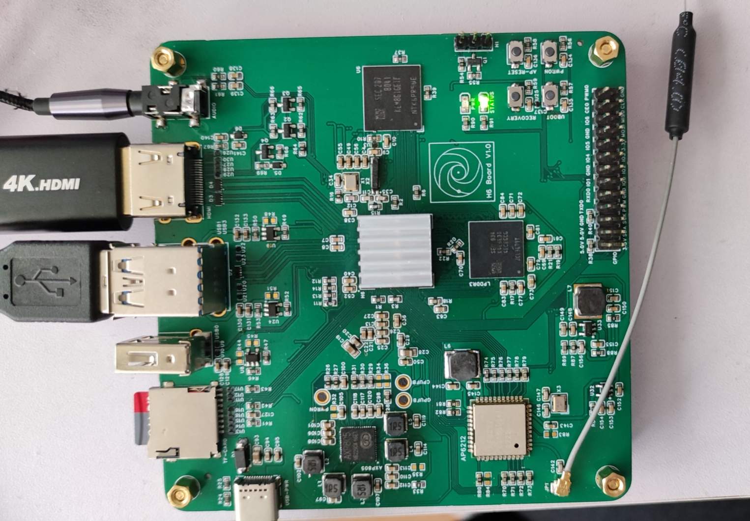

# Quanzhi H6 Development Board
## Introduction
The Allwinner H6 development board uses the Allwinner H6 as the main control chip, and has 2GB LPDDR3 memory, 8GB EMMC, AP6212 (WIFI+BT), common USB, HDMI, headphone audio and other interfaces, and an open 26Pin GPIO.
The hardware is compatible with Orange Pi 3 LTS and can be programmed into the Orange Pi system and fully connected to its software. For example, use the GPIO operation tools provided by Orange Pi to operate the IO ports.

* Based on Allwinner H6 chip, 4-core Cortex A53, Mali-T720 GPU
* 2GB LPDDR3 memory (tested by DragonHD, up to 888MHZ) and 8GB eMMC storage, supports TF card expansion
* HDMI supports up to 4K@60HZ, measured at least 2K@60HZ
* Onboard AP6212 (WIFI+BT) (WiFi speed measured download 30Mbps+, upload 20Mbps+)
* 4 USB ports, Includes 1 USB 3.0, 1 USB 2.0, 1 USB OTG, and 1 USB Type C power interface
* Supports HDMI and 3.5mm interface audio output (clear sound quality, no noise)
* Onboard 26 Pin GPIO, supports common interfaces , eg. I2C, SPI, UART, PWM, etc., compatible with the GPIO interface of Orange Pi 3 LTS
* Independent debugging serial port, outputs UBOOT and kernel debugging information at startup, can be used as Console after entering the system
* Paired with AXP805 power supply solution
* Supports eMMC and TF card boot
* Support direct burning of firmware through debugging USB (Android system only)

* There is a problem with the schematic library of LPDDR3, where the G6 pin is actually VSS, which is wrong in the schematic Think it's VDD. (The correctness of the devices found in EDA was not carefully confirmed at that time)
* AP6212 Bluetooth failed to be adjusted. It is speculated that the software configuration is incorrect.
*~~It is speculated that there is a slight power integrity problem. It may be because I use 0603 package capacitors instead of 0402 packages, so that all capacitors cannot be placed closer to the main control chip. ~~
* **Changed the power supply of the development board from an adjustable power supply to a mobile phone charger, and the problems caused by power integrity are no longer visible**. It has been running stably for 30 days.
* My guess is that the power quality of a mobile phone charger is better than an adjustable power supply costing 100 yuan+.
