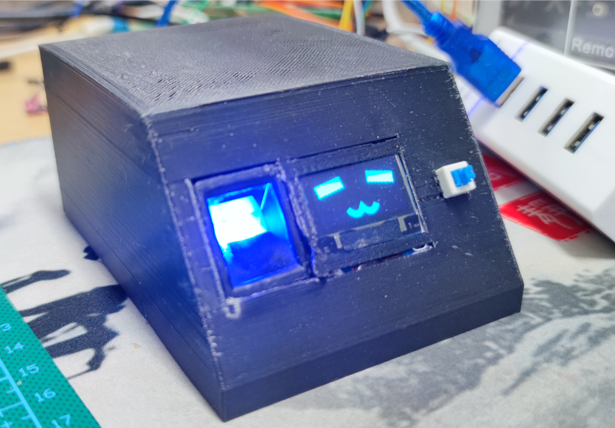

1. If the fingerprint is entered correctly, the OLED will display the power on and fingerprint ID.
2. If the fingerprint is wrong, OLED will prompt to compare again and display that the computer is shut down.
3. If the NFC card is swiped correctly, the OLED will display the power on and fingerprint ID.
4. If there is an NFC error, OLED will prompt to compare again and display that the computer is shut down.
Compare the information through arduino uno/nano, and pull the corresponding I/O level low. The I/O level is read by esp01s and sent to the receiving end in the same LAN through the TCP protocol, and then a low level of more than 500ms is input to the Power pin of the computer motherboard to start the computer.
The code is downloaded in the attachment.
