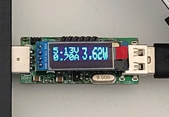

1. Project function introduction
Based on N32G430C8L7+INA199, the USB ammeter with an accuracy of 1% can be used to check the current when the USB is working.
2. Project attributes
0.91-inch OLED screen, clear and compact display effect;
PCB board adapts to the public version shell;
low-resistance sampling resistor is used to prevent excessive internal resistance from affecting the USB power supply efficiency;
Maximum voltage measurement support: 6V
Maximum measurement current: 2.8A
Support power display

6. Photo display
参考设计图片
