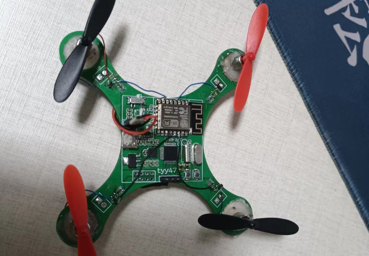

This project is developed using N32 and esp8266, where N32 is used for main control and data processing, 8266 is used for WiFi connection and serial communication with N32, and 4G module or wireless Wifi is used for ultra-long-distance control in the future.

*4, hardware part
1. There was an error in the purchase of the motors in the four positions. The hollow cup with a diameter of 7 mm was regarded as a radius of 7 mm, resulting in insufficient power and failure to take off.
       2. Compared with the sot-23 transistor and mos tube of the same package, the unidirectional conduction control of the transistor is more effective.
       3. PW5100 cannot load esp, N32, and MPU6050 at the same time, so remove PW5100 and related components in the project.
