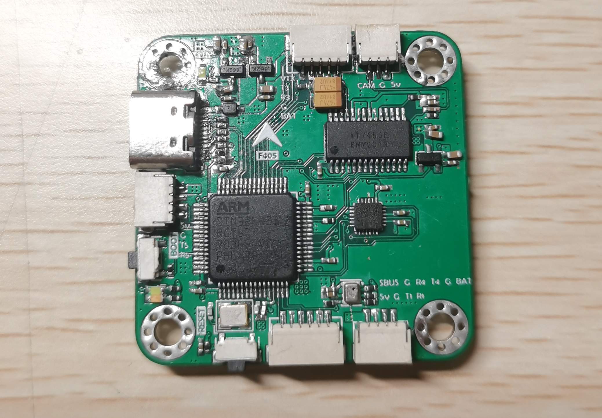

[Open Source] Homemade F405 flight control (supports Betaflight firmware and secondary development)
The hardware cost is about 70~80 yuan.
Specific functions:
1. Supports 6s voltage direct input
2. Onboard mpu6500 gyroscope
3. Onboard bmp280 barometer
4. Onboard AT7456E
5. Supports 5-way serial port
6. Supports black box external sd card
7. The flight control supports up to 6 axes
8. Supports direct plug-in to the DJI air unit
9. SWD download interface
10. Full direct plug-in SH1.0 interface design
11. type-C interface
12. For physical demonstrations of BOOT and reset buttons,
see the video on Bilibili , video link: [[Open Source] Homemade F405 flight control (low cost of 70~80 yuan, free proofing by Lichuang Design, supports Betaflight firmware and secondary development)] https://www.bilibili.com/video/BV1MV4y197aP/? share_source=copy_web&vd_source=13c8065083222d979eaa108383df780a
[[Open source] Homemade 70 yuan F405 flight control gyroscope-barometer test (see top comment for open source link)] https://www.bilibili.com/video/BV1nL411Q7bb/?share_source=copy_web&vd_source=13c806508 3222d979eaa108383df780a
thinks Yes, remember to connect
the Gerber file, firmware HEX file and pin configuration file in the project attachment.
The physical picture is as follows:
