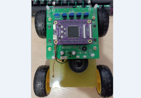

Kinda cute car
  According to the routine provided by the training camp, the car has Bluetooth remote control, infrared tracking, ultrasonic obstacle avoidance, PWM speed regulation, and a very good voice module control function. It has two headlights and a turn signal. 5mm direct plug-in full-color LED, you can adjust the color of the turn signal according to your own preferences.
1. Small car owner control core board (Liangshan Pai development board)! [image.png] The main control chip of Liangshan Pai development board is GD32F470ZGT6
with onboard RGB & 8080 screen interface, and also has rich peripheral reference materials, making transplantation more convenient

The last and most important thing is that I only briefly tested the voice control, and other functions need to be improved. Since the car ran so fast, the wind was too strong to hear what I said, so I could only hold it in my hand. Tested forward and backward on
