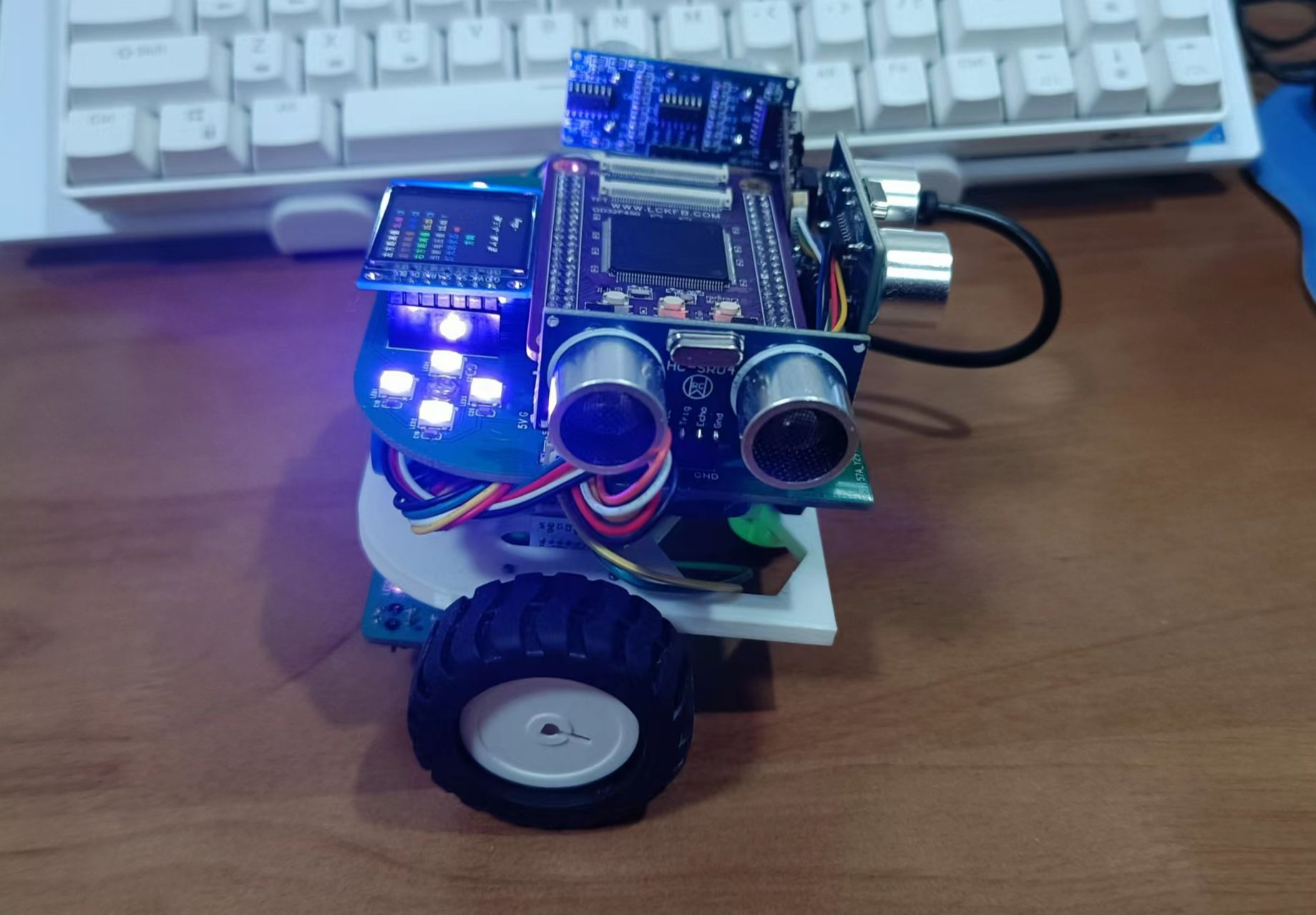

![WeChat picture_20230227201542.jpg] ## The physical picture of the small three wheel
shows the startup animation after powering on:
![WeChat picture_20230214213753.jpg] Then it starts to automatically display the distance measured by the ultrasonic wave, the size of the voltage value, the light and the direction.
![WeChat picture_20230214213728.jpg] Front view of the car:
![WeChat picture_20230214213724.jpg] Side view of the car:
![WeChat picture_20230214214020.jpg] _**Thank you very much to Lichuang for giving me a chance to do it with everyone. Smart car opportunity! Let everyone experience the joy of making a car, haha. **_
