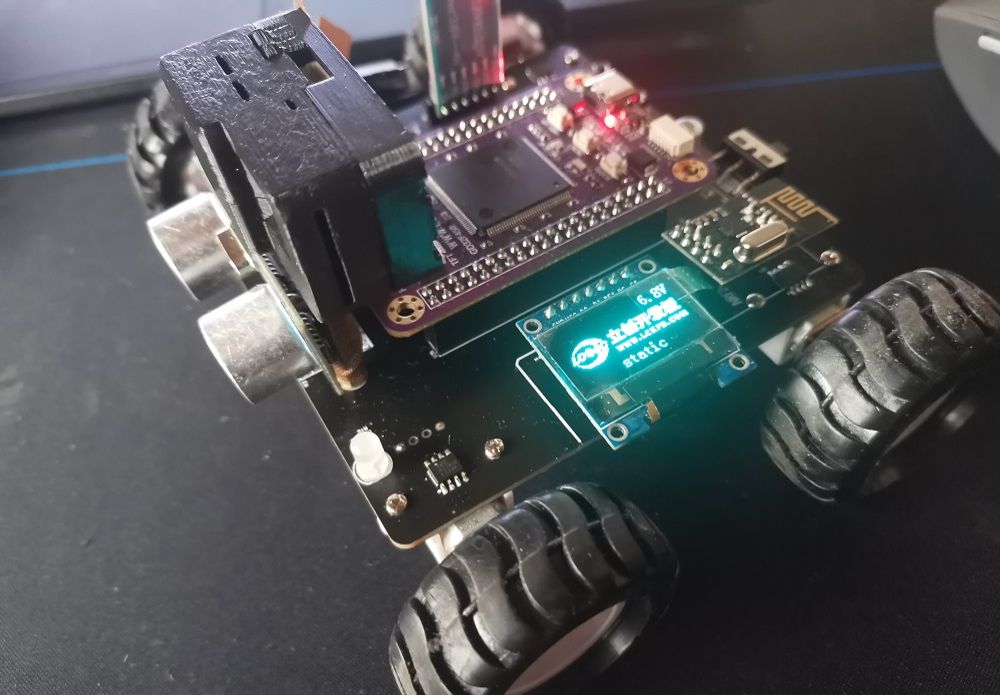

The official extended version of Lichuang development board integrates many functions, which is completely sufficient for smart cars. However, since I had completed infrared tracking for a long time when making a car before, I removed the infrared tracking this time and switched to OPEN MV for tracking and other visual tasks.
Also, as an expansion version, how can it not have a screen? So I connected the spi interface used by NRF24L01 to the screen.

## 2. Hardware Analysis
### The resources used on the extended version are as follows:
`Serial port 0 ----- used to log when the program is running`
`Serial port 5 ----- used to communicate with OPEN MV `
`Serial port 6 -----used for Bluetooth module communication`
`SPI3------used for NRF24L01 communication and screen display`
`TIMER1 and 2--used for controlling N20 motor`
`TIMER5---- -Used to start scheduled tasks`
`ADC0-------used to measure battery voltage`
`GPIO-------used for control pins of buttons, lights, ultrasonic modules and other modules`
### The specific hardware circuit implementation
emmm, there are too many people writing this. The official version of Lichuang Development Board is already very good, so I won’t write it anymore (~~I’m actually lazy~~).
### Disadvantages:
1. I used the AMS1117-5.0 buck on the board (because it is cheap), and there was no problem in the beginning. But when I connected to OPEN MV, the power consumption increased greatly, 1117 became seriously overheated, and even experienced a brief power outage. These were all caused by overload. . . It can be replaced with a switching power supply and a high-current buck circuit such as
2. When the battery is not used, connecting the development board to the debugger power supply will cause voltage to appear at the input end of the voltage stabilizing chip, and the motor will be driven (although the USB port of my computer was not burned, But it is not safe after all). So I disconnected the power supply between the debugger and the development board. From the hardware point of view, it seems that I can add a diode between the output of the voltage regulator chip and the 5V input of the development board (feeling a safe point?), but there will be a voltage drop. Should I install a MOS tube in conjunction with it? It feels like this is okay. Add a physical button to control on and off (forget it, it feels like it will become complicated, um, pay attention next time).

![Tracking.jpg] ## 4. Physical display
of the car~~~
![Car1.jpg] ![Car2.jpg]
Remote control~~~
![Remote control handle.jpg]
Screen
![Screen.jpg ]
