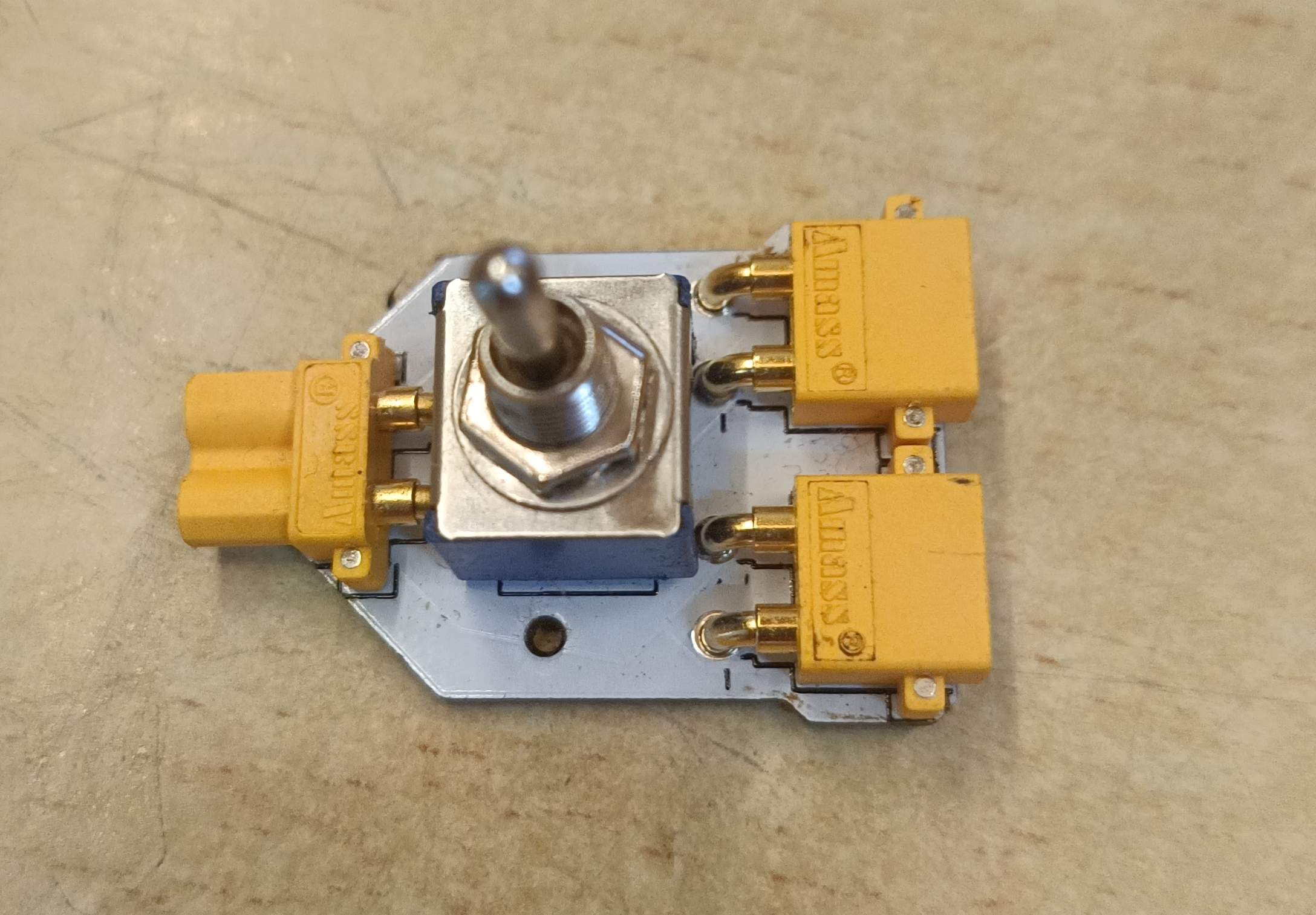

Power supply serial-to-parallel conversion module
*Note: Do not connect two batteries with different capacities (it is generally believed that if the S number is different, it is okay to connect batteries with the same capacity in series. You can refer to the parallel connection method of general aircraft model battery cells); it is generally not recommended to use two batteries with the same S number in parallel. ;
This solution is only designed to expand the battery voltage value and be used with batteries of different numbers.
The silk screen is printed according to the direction of the toggle switch (because the circuit below has a path that is just opposite to the direction of the toggle switch, refer to the component manual)
. The original file was transferred using AD, and the original file is in the attachment.
