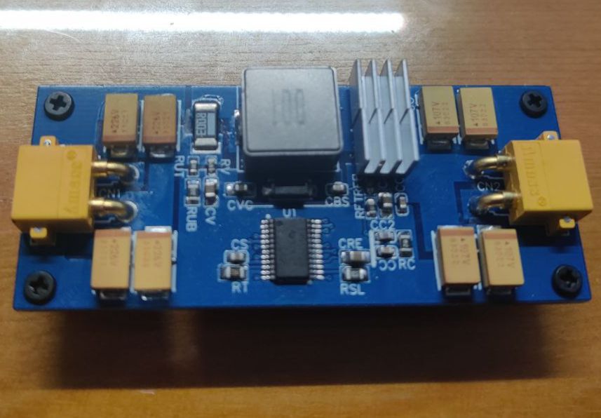

Based on the LM5122ZA design, the cost is relatively low. The default output is 24V and starts at 6V. The maximum output power is only measured at 144W. If a better radiator is used, it should be able to reach higher. Currently at 144W, excluding line losses, the efficiency is 97%
