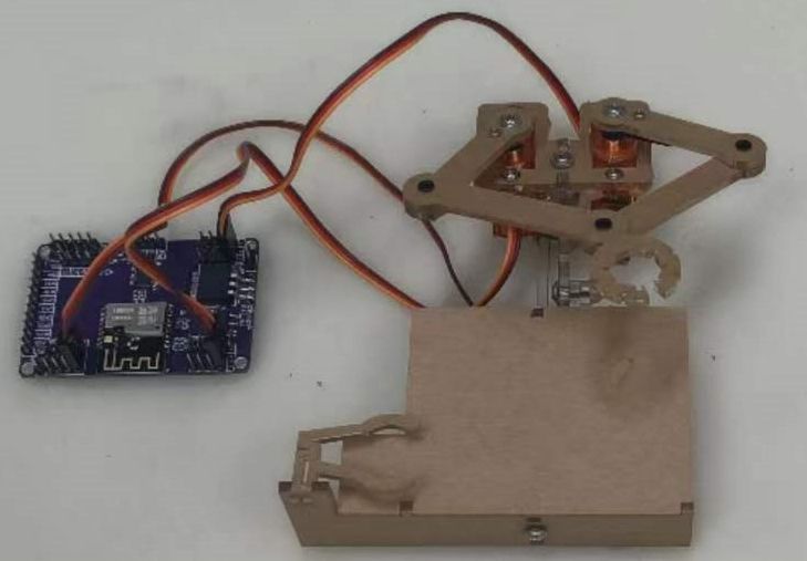

Realize the basic functions of Xiaojian Clock, draw a circle, and continue to improve it later.
It is developed based on the OpenHarmony open source Hongmeng system. The chip used is hi3861, which supports 16-channel servo control, GPIO, ADC, PWM and other operations.
Common operations such as writing and drawing graphics have been implemented
Chip solution: multi-channel steering gear control board based on HiSilicon Hi3861 chip and PCA9685
Product core parameters:
Working voltage: 7.4V~20V with overheating and overcurrent protection
