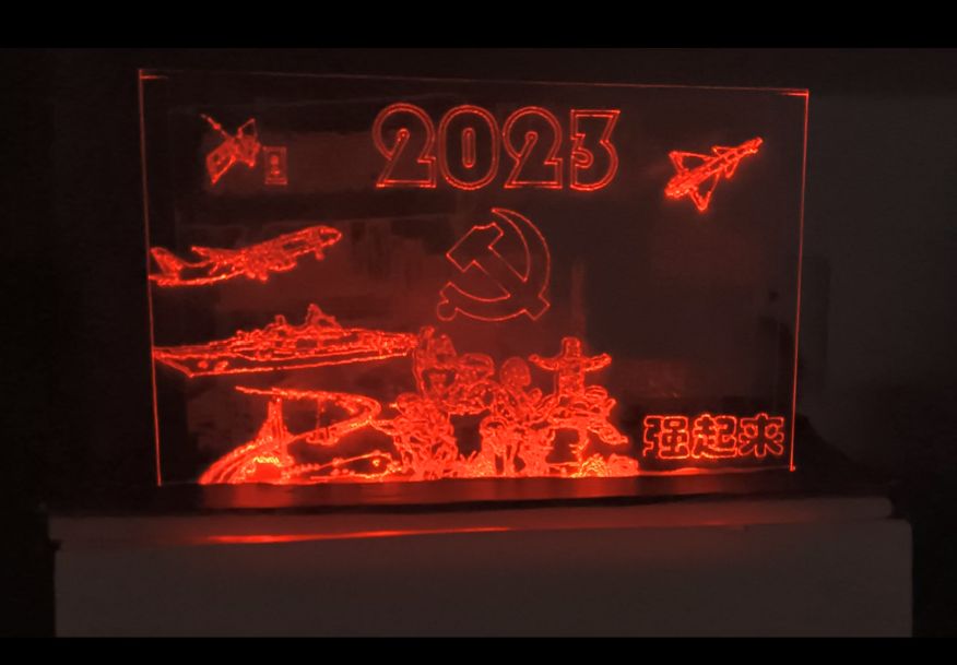

The idea of ​​producing a red-themed audio
display effect according to the requirements of the event comes from the up owner of B station: Black Black Technology https://www.bilibili.com/video/BV19V4y1F7sf/?spm_id_from=333.999.0.0

Taking advantage of the differences produced in the production process of transistors and other devices, LED Flashes regularly to achieve a flowing water effect.
3. Oscillation period T: Calculation In the above circuit, Q1 and Q2 act as two electronic switches. The switching of the electronic switches is determined by the RC time constant, which determines the pulse width of the square wave. Practice has proved that as long as T=0.7R2C1, the charge on C1 is basically discharged, and the base voltage of T2 changes from negative to 0. T1=0.7R2C1, T2=0.7R1C1 The sum of the pulse widths of the two square waves is the repetition period: T=T1+T2=0.7 (R2C1+R1C1) If R1=R2, C1=C2, T=1.4RC
we can pass Changing the resistance of R2 and R3 changes the speed of the running water lamp. In
this
 circuit, changing the resistance of the potentiometer affects the charging and discharging time of the capacitor and changes the on-off time of each of the three groups of LEDs. Actual picture
参考设计图片
