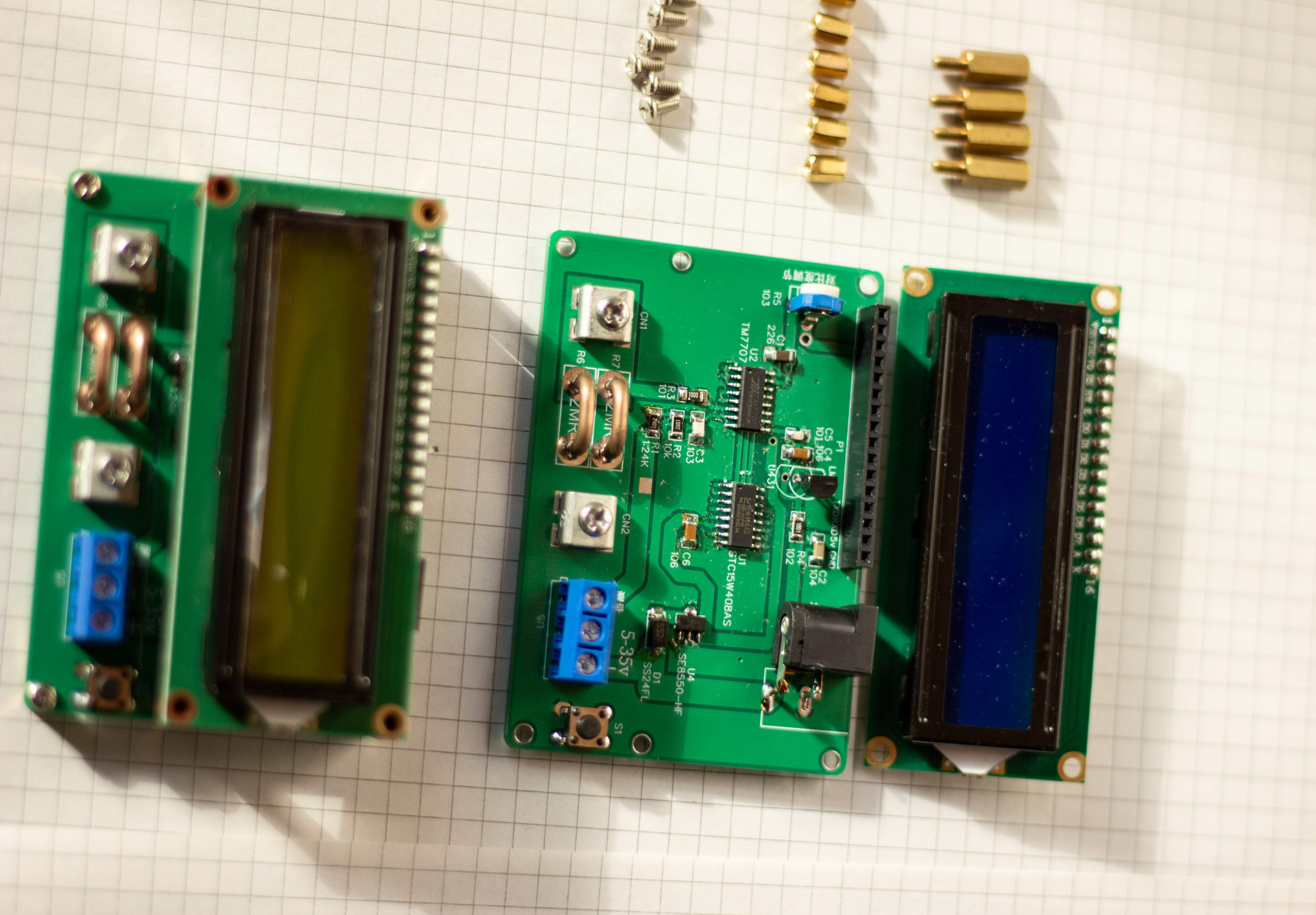

This is the first current, voltage and power hybrid detection instrument I made. It uses the STC15W408AS microcontroller with the TM7707 analog-to-digital conversion IC. After the voltage reference TL431 (LM385) is welded, debugged and calibrated, it can measure voltage, current and power in real time, and also adds load impedance test.
The PCB design power supply voltage is directly connected to the microcontroller and A/D sampling and the 1602 LCD screen to ensure the stability of the input voltage. It supports 5~30VDC wide voltage power supply. If it exceeds this range, please power the meter head independently.
If it is used to measure the capacity of the battery, please make sure that the battery has a protection board or other low-voltage measurement protection device. The meter head does not have a low-power stop function. Pay attention to the positive and negative poles of DC measurement to prevent the risk of fried chicken. I have informed the measurement risk. If there is an accident, it has nothing to do with me. I will be responsible for it.

When designing the PCB, the voltage reference is designed with TL431 and LM385. When welding, please choose one of the two. You don't need to weld two.
The contrast of the 1602 LCD display can be adjusted. Please buy a vertical one. Of course, I also added pads when designing. The horizontal one can also be installed, but considering that the 1602 display cannot be adjusted after installation, you need to buy a vertical one. The 2mR mark on the PCB is a constantan wire current-sensing resistor (pin spacing 10MM diameter 2.5MM) CN1/CN2 terminals are brass stretched welding PCB-9M3 or PCB-9M4 can be used to ensure the accuracy of the current, voltage and power meter. The resistors and capacitors on the PCB are as high-precision and low-temperature drift as possible (stacking rule: what electronic strange rule, when your own PCB is very LOW, use very expensive components to stack materials, and some gold-plated pins are not impossible to improve the work. )

There is no design and production of a shell.
When designing the DC power socket, the size was not considered well. The display screen will be blocked when inserted into the mother socket. Later, it was forced to be installed horizontally. The aesthetics is not very good and can be barely used.
Due to limited conditions, I do not have a power supply with particularly high accuracy, that is, my voltage and current meter is calibrated with a general adjustable power supply. The accuracy may be accurate when calibrated by a good power supply. I hope that the creators who have the conditions will boldly help me try. Thank you! 6. About proofing and welding
1. Proofing can be directly opened with the attachment editor for proofing, the default proofing option.
2. For welding, first solder the patch and then plug it in directly. There are not many components, so welding is more convenient.
