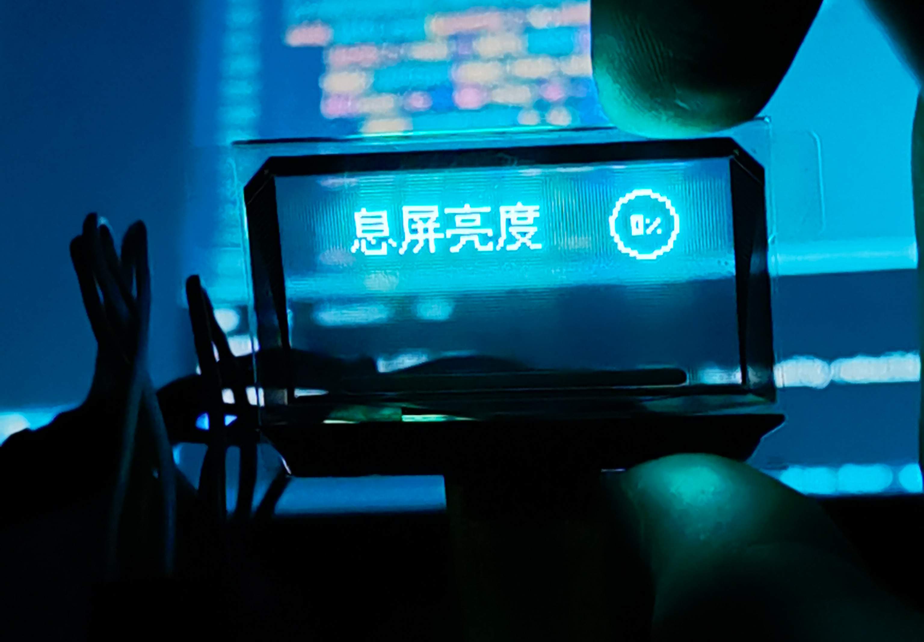

# It's very painful. All sensors in the epidemic area have not been shipped.
1. **Since the sensors have not been shipped, I can only put the time on the screen. Originally, N32 detected the sensor data and communicated with the 8266 serial port. Now the result is that only the serial port transmission and reception are verified. The sensor will be tried again when it arrives. **
2. **There is no problem with the hardware verification of 8266 and N32. The power chip cannot be started. There is no problem with the circuit program. The IIC output is also normal. I am going to change the chip and try again (fake chip???)**
3. **Memorial knife head hand welding QFN package. 。 。 。 **

First of all, there are two main control chips. ESP8266EX is drawn separately, and N32G430C8L7 is drawn separately. In order to run stably, I think the two MCUs are powered by two LDOs respectively. Since 4-layer boards will be drawn in the future to compress the size of the circuit board, in order to solve
the problem that the multi-channel LDO power supply is too large and also needs to take into account battery charging, power detection, long-press on and off, power overcharge and overdischarge, high temperature and power protection, etc., which require large-area components and layout, the power management chip is introduced. In order to fully support the domestic "U", the powerful APX173 power management chip is selected. It not only uses a small QFN package, but also perfectly solves all the functions I mentioned earlier (although the power ripple is average when multiple power supplies are supplied, it can't stand too many functions). Below I will directly attach a picture of the characteristics in the datasheet to feel its power.

I mainly wrote the UI, and will open source it after sorting it out. The transparent oled is really beautiful.
