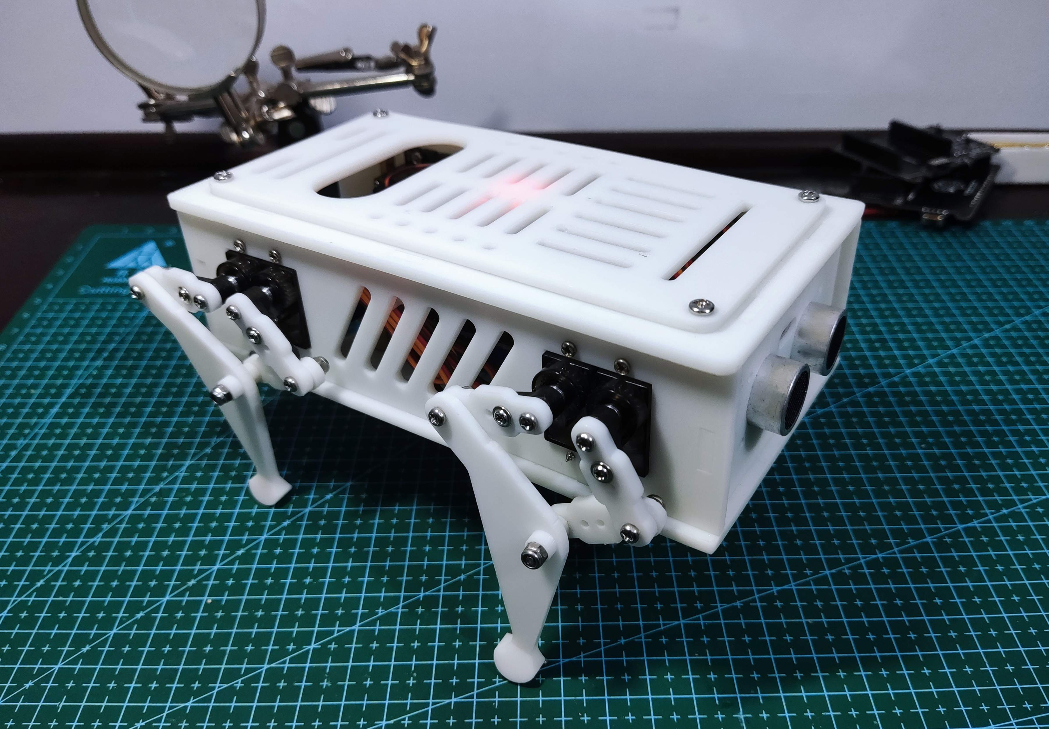

A four-legged robot dog based on Chuanzhi Hi3861 module. The legs are composed of a total of 8 mg90s servos, each leg has two degrees of freedom. Based on the inverse solution of kinematics, it can realize rich action modes. Bluetooth remote control and preliminary verification of face following functions have been added.

structural design
See attachment for solidworks modeling files硬件部分/hardware/structure
Structural optimization
  • The volume of the sole of the foot is expanded to increase friction.
  • Added side and bottom slots to reduce overall weight and facilitate expansion module installation
Fastener selection
  • M2 screw nut
  • M2.5 10 nut
  • M2.5 16 screw nut
  • M3 15 double-pass copper pillar
  • M3 40 double-pass copper pillar
  • M3 nut
3D printing
Use the light-curing printing provided by Jialichuang 3D Monkey, the material is SLA photosensitive resin
