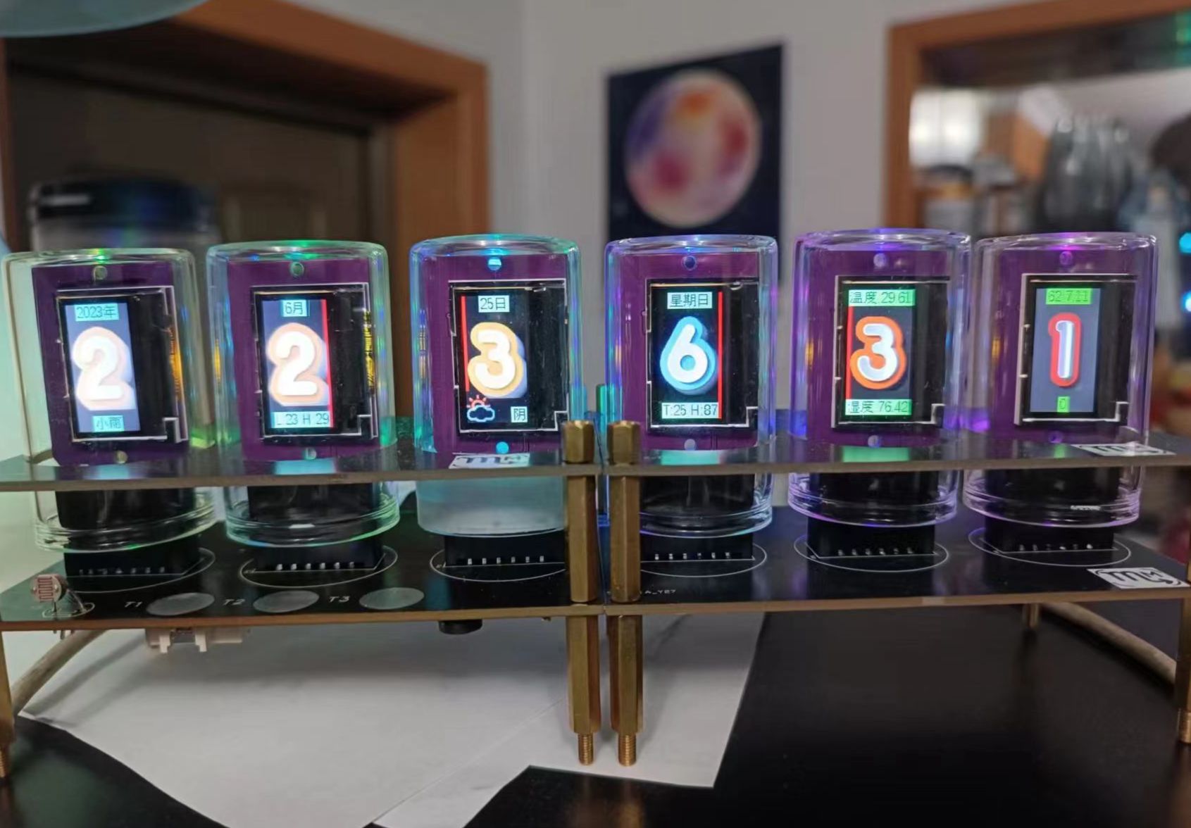

The structure of this project is modified from an imitation Nixie tube clock, but the original project cannot be found.
Program functions refer to multiple weather clock works
. The screens of this project are 1 stock screen. This production can also be regarded as a consumption of screens. Of course, Most of the open source works can be replaced with other screens.
Due to the number of display digits, the length of the PCB cannot be prototyped, so it was modified to a 2-stage type, with the main unit and part of the display separated.
Since I couldn't find a suitable test tube type glass cover, I used some " Internet celebrity succulent glass bottle" as an alternative. However, the sizes of these bottles are not consistent, and it has been thought that it is a PCB slotting accuracy problem that leads to multiple proofings. Finally, from the 20 bottles purchased, 5 were selected that were too large and could be fixed on the stand.
After that, the fixing frame slot can be adjusted smaller. If the bottle cannot be installed, you need to polish it yourself, or change the slot to a larger size and find a way to fix the bottle yourself.
Main functions:
1. Display time
2. Display weather forecast
3. Display ambient temperature and humidity
4. According to The program for automatically adjusting display brightness and RGB brightness according to ambient light
is still being improved. .
