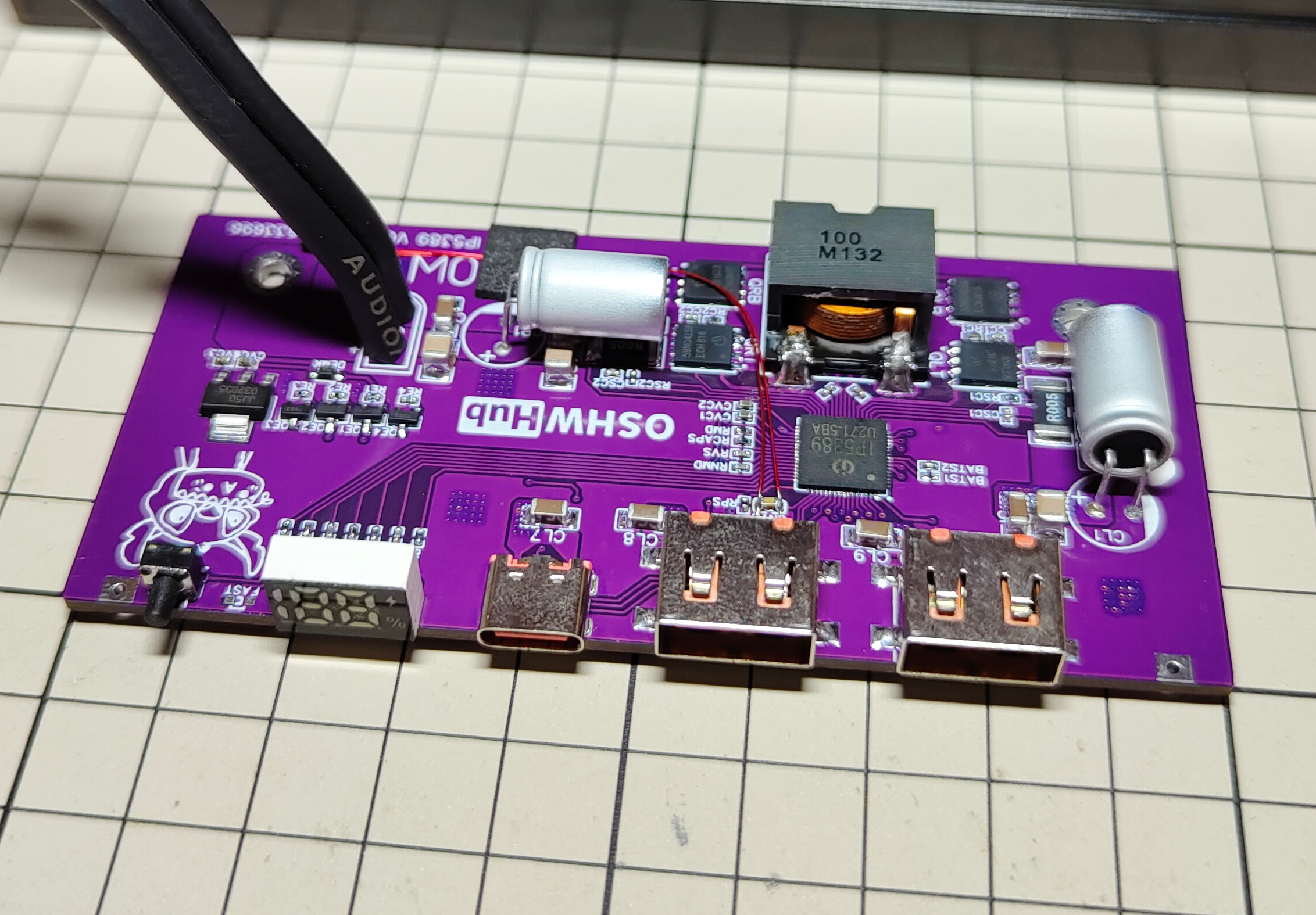

Modified from the Love Tomb Style No. 394 by Mr. Liu next door (click on the text to jump)
Updated to smaller size version on November 27, 2021
https://oshwhub.com/wzw666/ip5389mini
Supports 2-5 string battery packs
Also supports lithium iron phosphate batteries (need to replace the resistor to set the battery type)
Input and output power up to 100W
Actual measured charging power of 3 strings is 80 watts
4 string charging power 100 watts

The chip uses IP5389_BZ
The inductor used is Sumida’s CDEP1411NP-100MC-95

When the board is inputting and outputting high power, the current at the battery terminal is very large. Please pay attention to the battery selection.
The board does not have lithium battery protection and balancing circuits, and a protection board with balancing function needs to be used on the battery side.
The power MOS is BSC059N04LS6. This MOS has a small Ciss, high efficiency and low heat generation.
As the output switch MOS, any one with low internal resistance will do.

The size of the board is 10 cm
The motherboard and panel are fixed with solder
The battery uses eight 21700 batteries, four in series and two in parallel (a bit like the bombs in the movie)
Using a 3.5mm plus 0.3mm thermal pad, the board can make good contact with the case (heat is conducted to the case)
