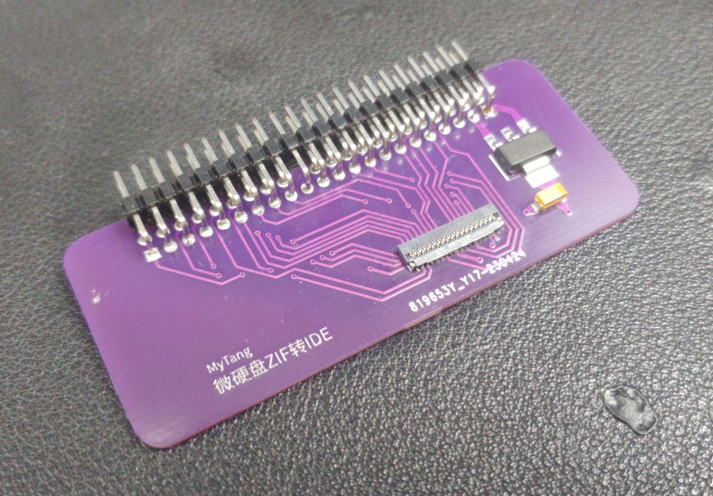

Micro hard disk ZIF to IDE
Applicable to the adapter board of 1 inch zif 35pin interface mechanical hard disk to 2.5 inch ide.
The actual test supports Hitachi HMS361008M5CE00 and Seagate ST680712DE.
It uses a CJT1117 + a 3216 6.3V 47uF tantalum capacitor as the voltage conversion.
The pin header is a 2.0mm pitch double-row bent pin. I use 2*40P here to cut off the excess part and unplug the excess pins and then weld them.
The fpc cable holder is a 0.3MM double-row staggered flat cable holder (35P).
The fpc cable is 0.3mm pitch 35P on the same
side after assembly.
The transferred ide can use the ide to usb adapter card or use the 3.5-inch ide to 2.5-inch ide adapter board to directly use the native ide to connect to the computer
