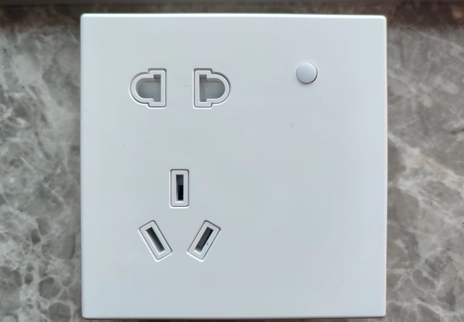

In response to the comments, the mature intelligent socket metering circuit is integrated into the 86-type concealed socket. Use the 86-type national standard five-hole socket shell, which can fit perfectly. And it has the following features: magnetic latching relay, energy metering, stable counting, OTA firmware upgrade.

1. This project actually requires two boards, namely the socket body (PCB thickness 1.2mm) and the MCU plug-in module (PCB thickness 1mm). 2. The power metering chip uses BL0942, which has the advantage of not requiring calibration and slightly more metering functions.
3. No isolated power supply is used, and the 220V AC L line is directly connected to GND, so the entire PCB is charged with strong electricity. During debugging, it must be plugged into the plug board with the shell for testing. Please cherish your life.
4. The key resistor accuracy needs to be 1%, pay attention to the BOM table. 390kΩ accuracy ±1%, 510Ω accuracy ±1%

4. Solder the ESP12S with the firmware flashed to the PCB
5. Solder the main PCB
When soldering the copper contact piece, the contact piece opening should face the direction of the arrow.
6. Various angles of soldering
Front view
Back view
7. Install the shell
8. Power on and debug
(wall crack suggestion: ******Don't debug directly on the wall******)
First install the plug line and debug on the socket. Wait until the debugging function is completely normal, then install it on the wall.
(Software and hardware installation completed)
