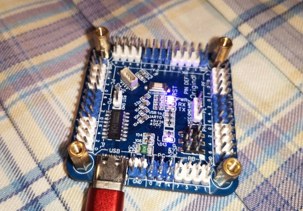

The picture below is the prototype board of version 1.2. The pin colors are distinguished according to the register.
Another prototype board using long headers to explore the limits of expandability.
The ATMega2560 development board has all IO leads (including IO not used by Arduino), on-board USB-UART conversion (CH340C), and can be used as a general Arduino 2560.
On the back of the board, the corresponding pin definitions in Arduino are marked (x means that Arduinio is not used), as well as a comparison table of some communication interfaces, which is convenient for newcomers like me and stupid loli who still only use Arduino after several years.
Don't ask me why Arduino's definition is so confusing, ask the Arduino team.
There are four LEDs on the board:
One is the power indicator light;
Two are UART0 (PE0, PE1) indicator lights;
One is the "L" light of Arduino's ancestral 13-pin (PB7).
There are three jumpers on the board (0603 0 ohm):
Two are MCU's UART0 (PE0, PE1) to CH340;
One is +5V to AVCC.
Just connect them all.
There are two optional resistors on the board:
The pull-up resistors of the IIC interface (PD0, PD1) are generally not connected.
I added IIC entirely because I personally prefer IIC and use IIC for everything.
