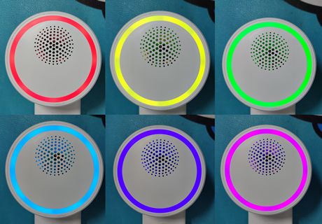

sensor, it should perform its duties quietly and low-key. But this sensor is too unserious. In addition to sensing ambient light (TEMT6000) and presence (HLK-LD2410B), it also uses colorful lights (WS2812B-2020) to show its presence to the world.
The colorful LED under the color ring can statically display a total of 16777216 true colors, and can also dynamically display more than 50 dynamic lighting effects including breathing lights (mode 2), gradient colors (mode 7), and marquees (mode 47).
