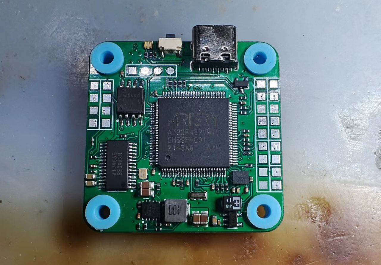

AT32F437 flight control
Due to the shortage of test flight video
chips, the price of flight control has soared with the price of STM32 chip... A domestic main control flight control board that can run betaflight 4.3 has now been launched! Based on the AT32F43/7 design, the performance (temporarily) beats the STM32F405!
Main control: AT32F435VMT7/AT32F437VMT7 288MHz barometer support: BMP280 (already measured), DSP310 (still needs to be fine-tuned) Gyroscope support: ICM42688P (already measured), BMI270 (already measured), LSM6DSO (still needs to be fine-tuned) OSD chip: AT7456 black Box chip support: W25Q128JV/FV (tested), W25N01G (still needs fine-tuning)
