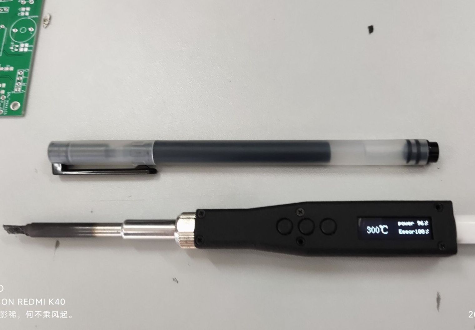

The main control uses Qinheng Microelectronics' ch224d used in the power supply part of Hongjing STC8H1K16 microcontroller. It supports QC/PD dual protocol deception and outputs 5~20v
 schematics/PCB and code as well as shell 3D files.
The link is continuously updated on github: https://github .com/yong-pii/Spark-T12.git
