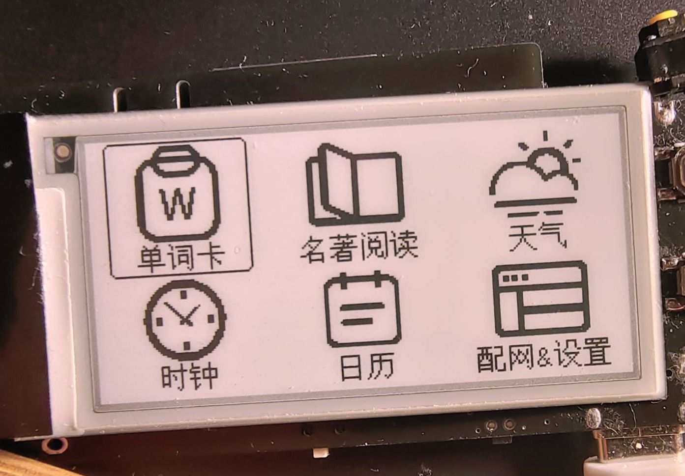

20221129 completed the main interface + word card function. Currently, other functions are still empty.
