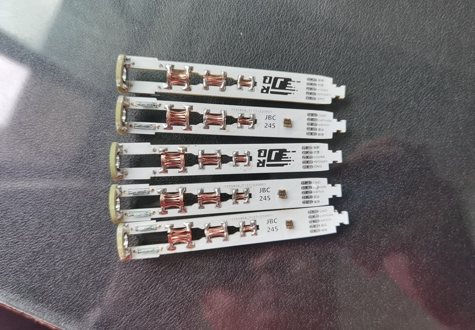

JBC universal handle bracket
It adopts a crown spring design and is equipped with a 2+1 sensor design, with 2 reed switches for omnidirectional sensing and a patch-type vibration sensor.
The patch-type vibration switch has a certain recognition rate. There is a 3% chance of being unable to sleep in the test. It is recommended to use a reed switch to pick up the heating and put down the sleep
tube yellow model.
