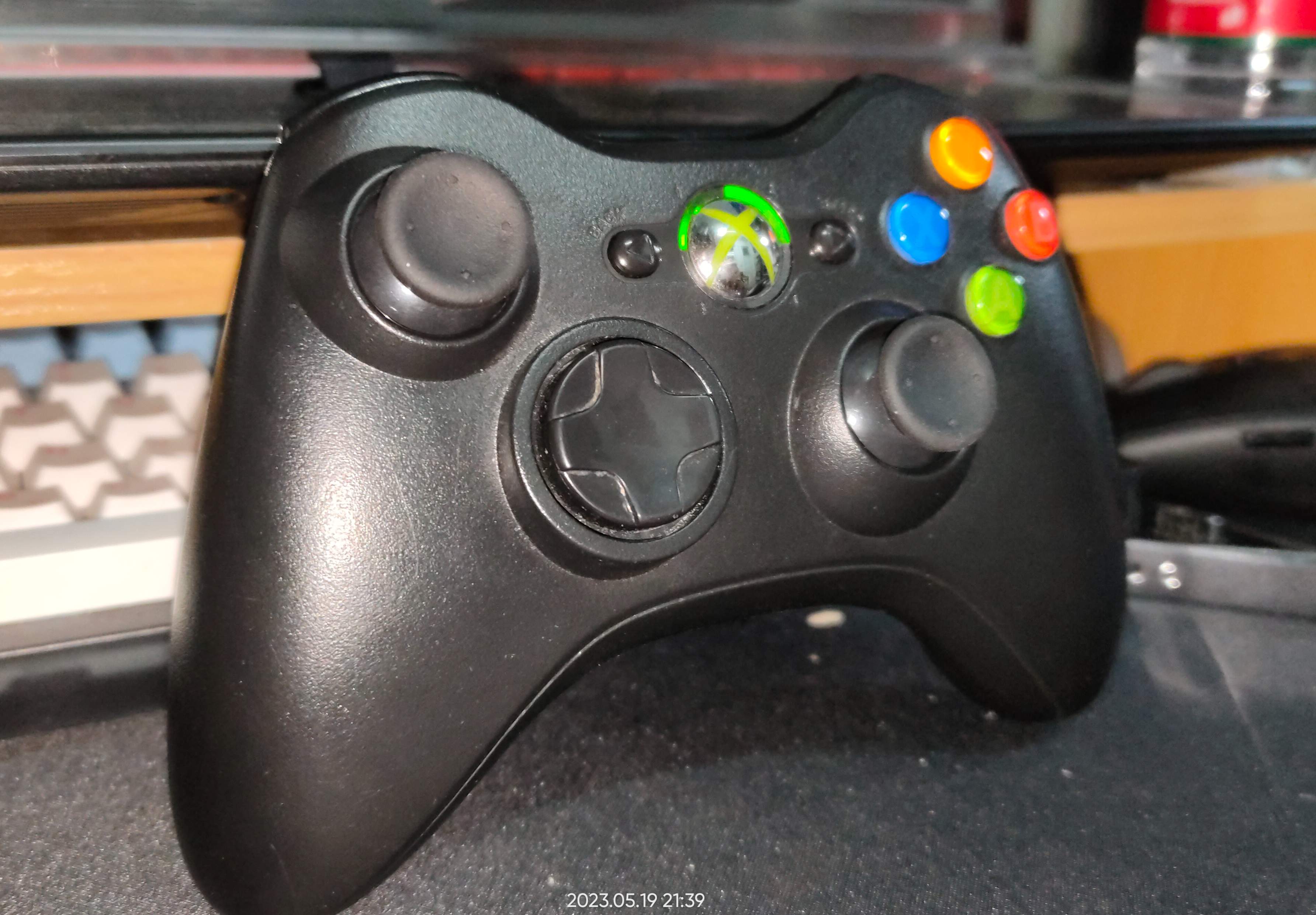

xbox controller changed to wireless bluetooth 2.4g controller
This project requires changing system functions! ! ! !
Since Espressif has not officially provided the receiving function for ep0, I can only add an xbox output statement to the enumeration function in the official file.
Copy and paste hub.c and hub.h in this path to integrate Bluetooth and 2.4
functions .
g dual mode, Bluetooth power consumption is about 100ma, 2.4g has not been tested, but theoretically the average power consumption is lower than Bluetooth. Since Bluetooth enumerates HID controllers, if you want to play games on the computer, you need to map it to xbox (using xboxce). The 2.4g data has been extracted and can be used as other peripherals (such as flight control handles). Since the trigger button of the handle in my hand is broken, I can't guarantee the accuracy of the Z-axis, but it should be accurate (I have a good impression of that mai maker, but I bought a new handle and he gave it to me. I was sent a version without a motor and the durability was not good. I told Huanhuo that the quality was really good before and I didn’t want to fight for something worth more than 20 yuan (he refunded me three yuan). Money hahaha)) Data frame definition: finished product
