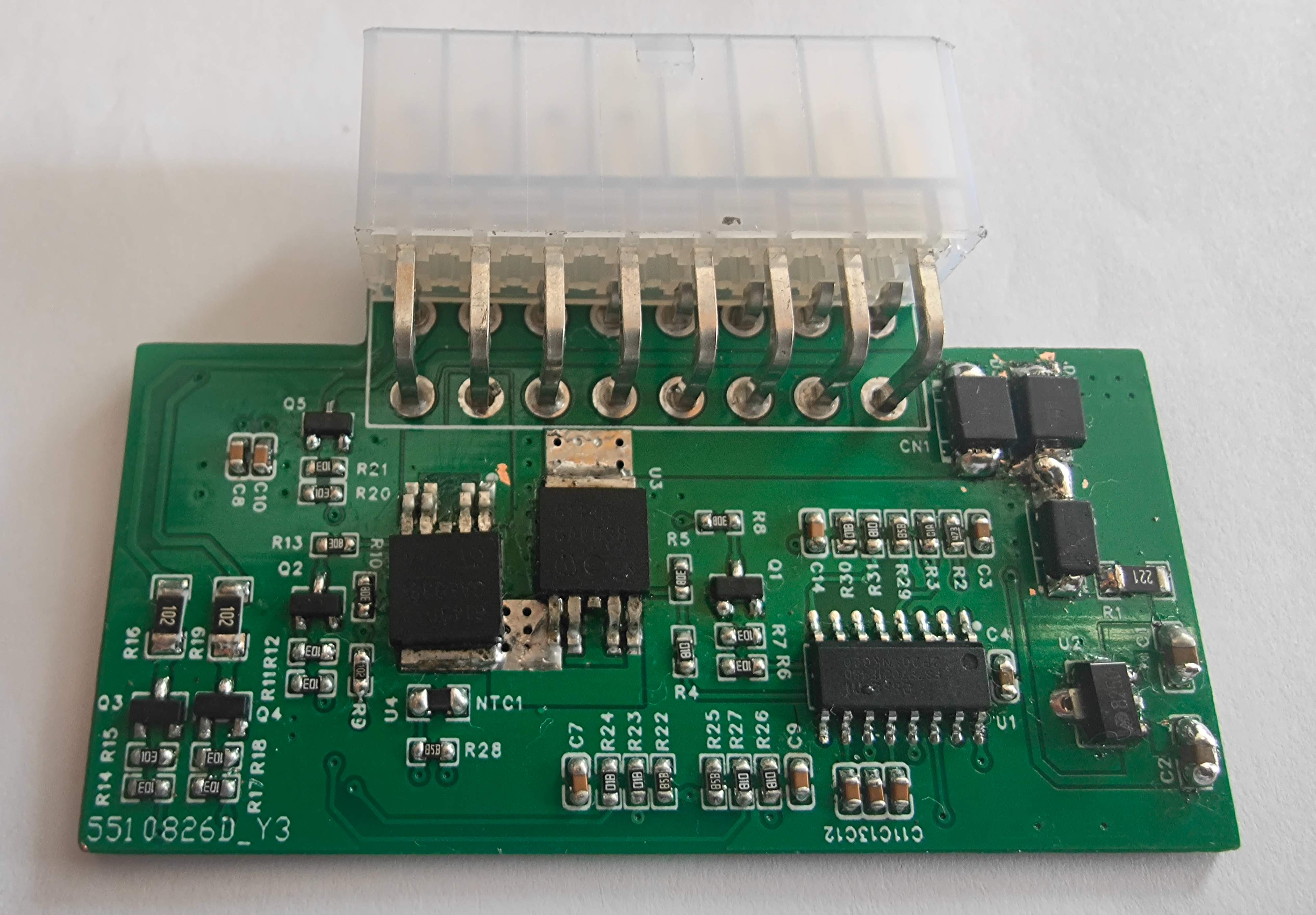

24V ventilation and heating controller
Summer is here
to use with a three-wire fan.
Neusoft Carrier ES7P7021F4SD is used for PWM control. Neusoft Carrier iDesigner or VS code can be used for development.
Infineon electronic power switch BTS6143D
realizes current detection by detecting the IS terminal voltage. The program defaults to 5A for ventilation
and heating. Rotate for 300ms to take effect. Use the knob. Switch detection gear
heating and
ventilation
interface definition
