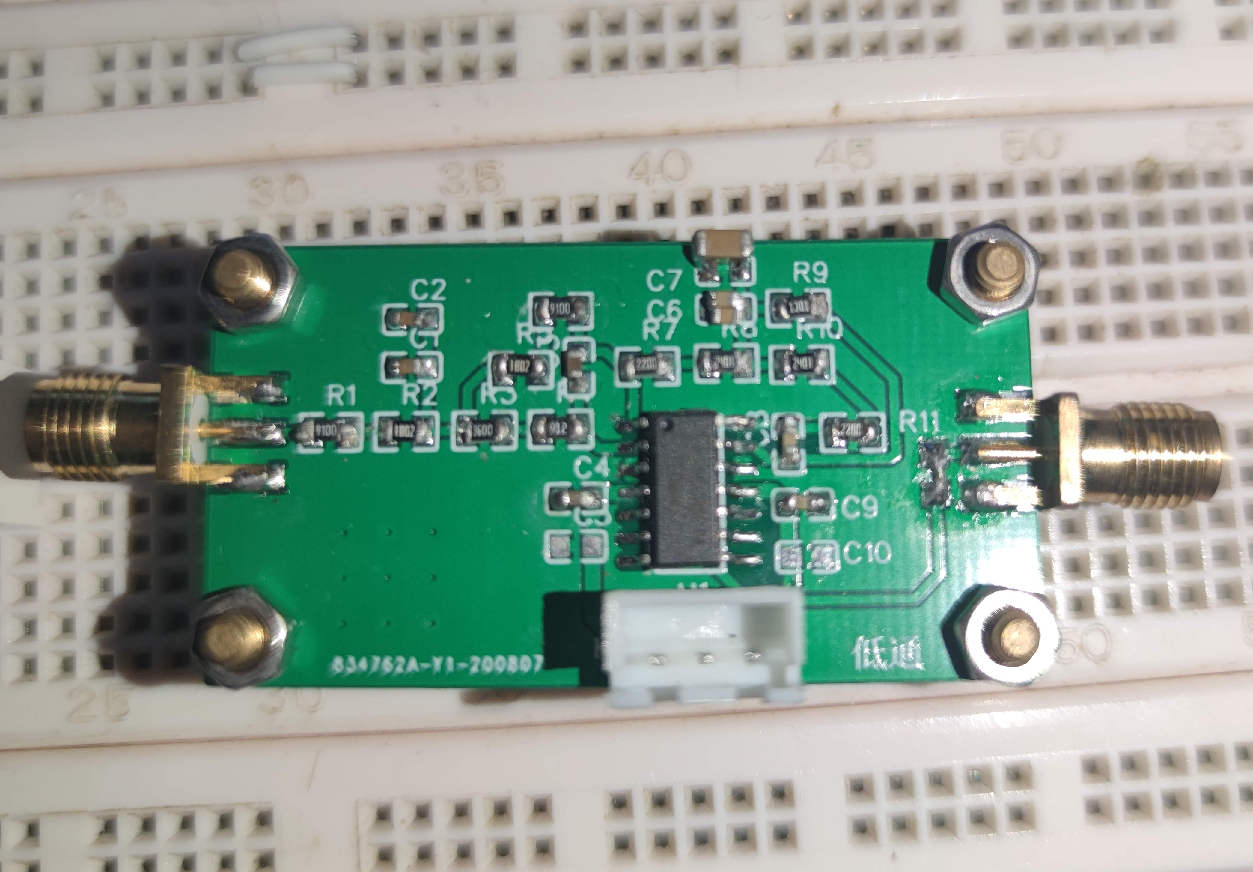

The filter chip uses TL084, a second-order infinite gain circuit, which is used to filter out the AC component and leave the DC component, which is then connected to the next-stage amplification circuit to detect the effective value of the input signal.
