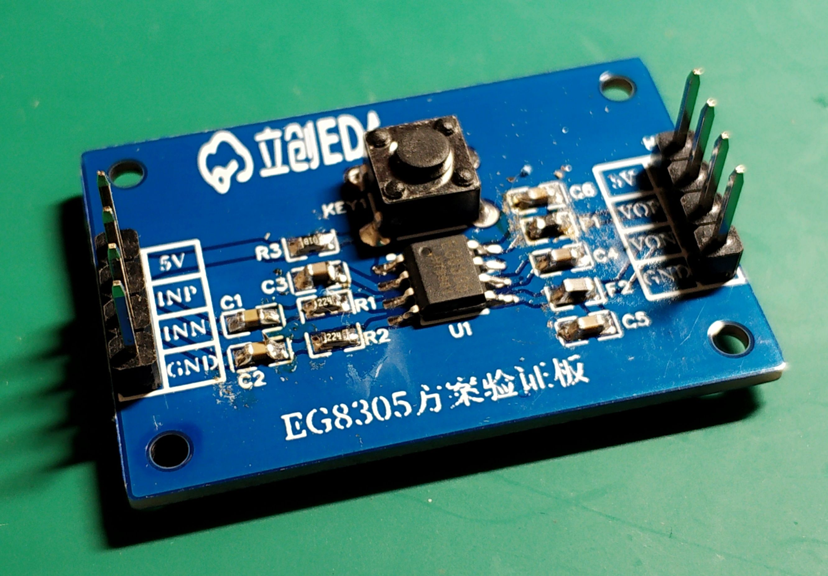

This project is used to verify the solution verification board design of Lichuang Mall audio power amplifier EG8305
This project is a solicitation project for Lichuang EDA open source hardware platform solution verification module
This design is a Class D audio power amplifier module based on EG8305
EG8305 is a 3W single-channel Class D audio amplifier produced by EG (Eijing Micro) Electronics Co., Ltd. The efficiency is as high as 90%, the startup time is fast, the peripheral components are few, the integration level is high, and the operating voltage range is 3.0V~5.5V
This design refers to the recommended circuit design in the chip manual, and uses pin headers to lead out the power, ground, and signal input and output ports of the module.
For more detailed chip parameters, please refer to the chip manual in the attachment.
