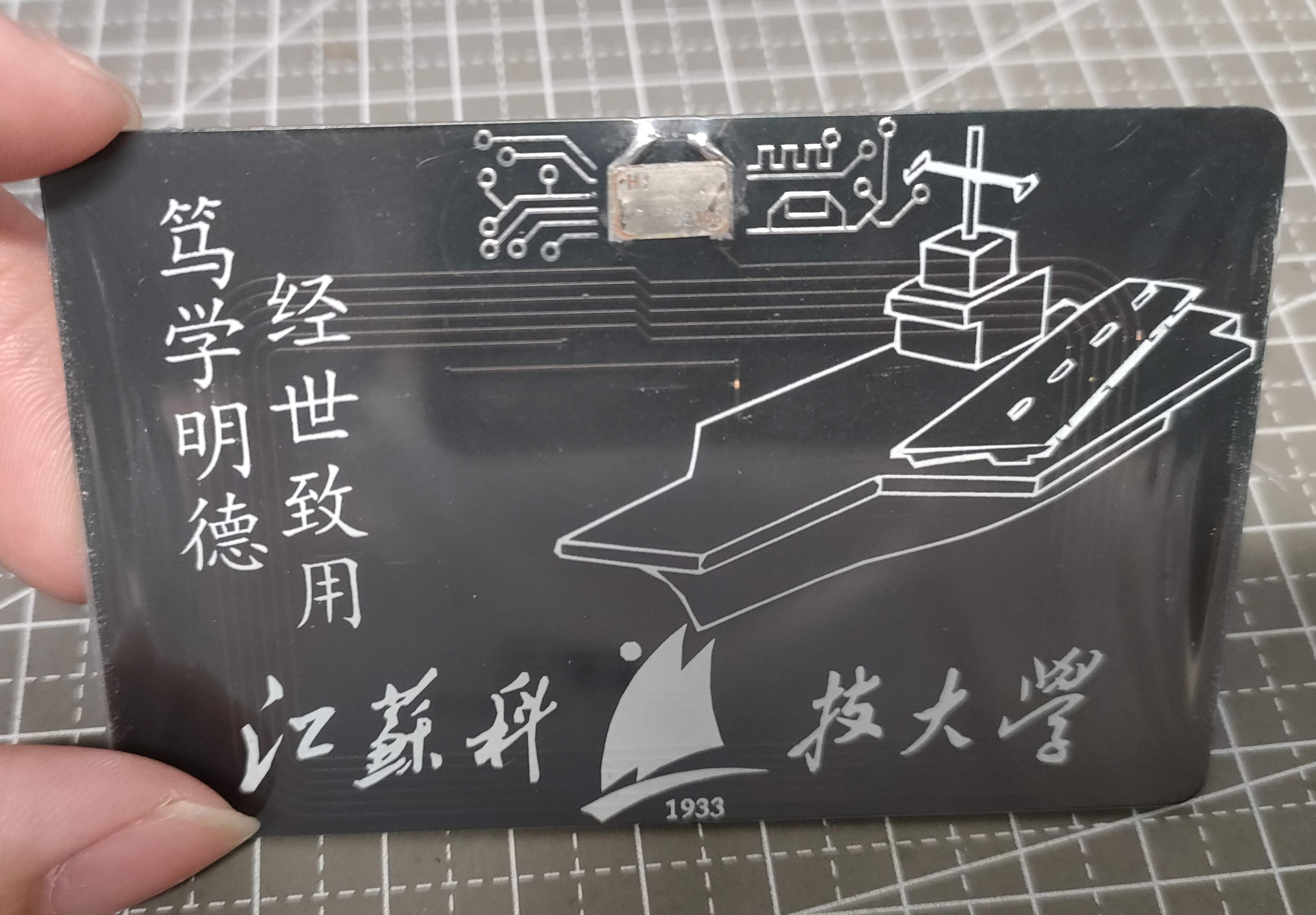

PCB campus card open source version
Engineering principle: PCB wires are used as NFC coils. There is an NFC coil on the front and back, respectively for chip power supply and LED light power supply. The two circuits are independent of each other.
