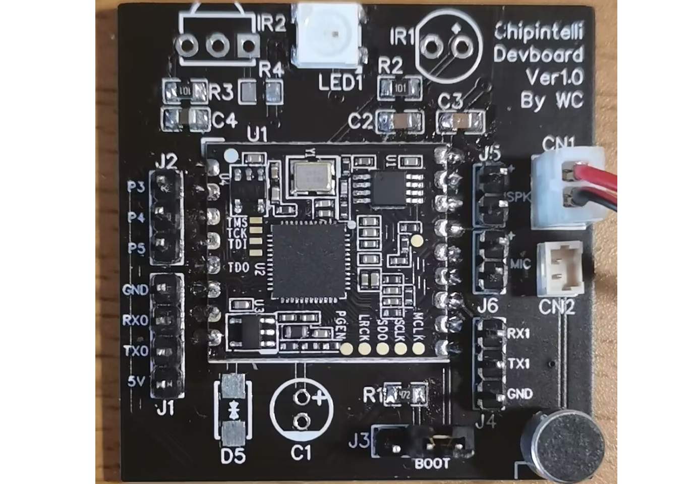

This is a development board based on the CI-C22GS02S module (CI1122 chip) of Qiying Tailun. It has onboard WS2812B colored lights, infrared receivers and transmitters. It can be used to develop applications such as smart voice night lights or air conditioner companions.
Currently, it supports voice control of PWM, ws2812 colored lights and infrared remote control (NEC protocol). The specific functions implemented are as follows:
* PWM: Only PWM initialization examples are given, and you need to write the lighting logic yourself
* ws2812 colored lights: verified
* Infrared control: verified, but currently only supports NEC protocol and has no self-learning function. You need to find a way to read the key code of the remote control by yourself.
The program code is located at: [https://github.com/DawningW/VoiceLamp](https://github.com/DawningW/VoiceLamp), welcome to star~
![Demonstration picture.jpg]

In this development board, move the jumper of J3 to BOOT to enter the download mode. After the download is complete, say "Smart Night Light" to wake up the night light, and say other command words to perform corresponding operations on the night light. The command words are as follows:
