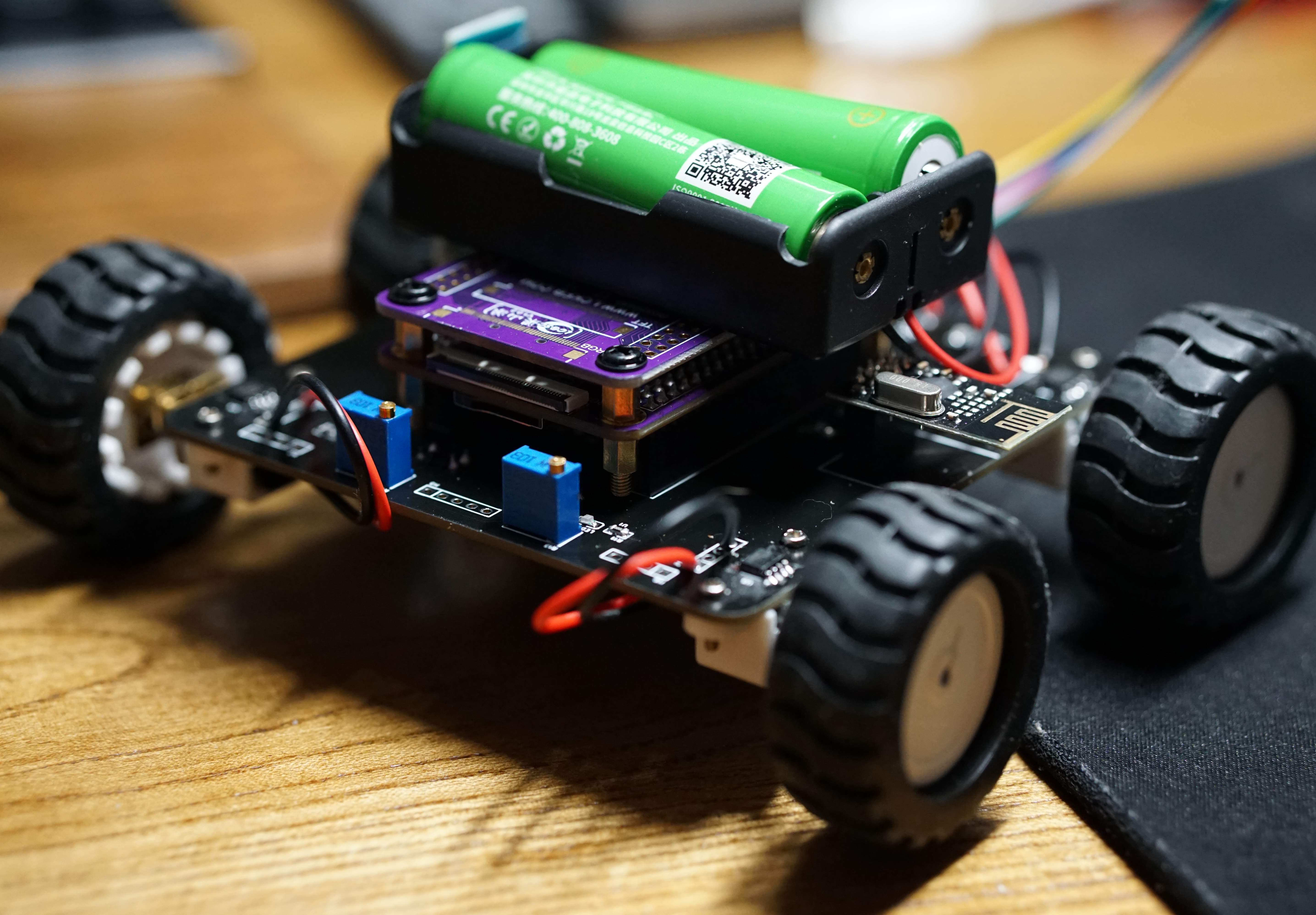

## Physical display instructions
The battery compartment is too tight, so it is all tilted
![DSC01222.JPG] It hurts my hand, so I took 3M glue and stuck it all on
![DSC01223.JPG] The poor Liangshan faction was used as a cushion
![DSC01224.JPG]
