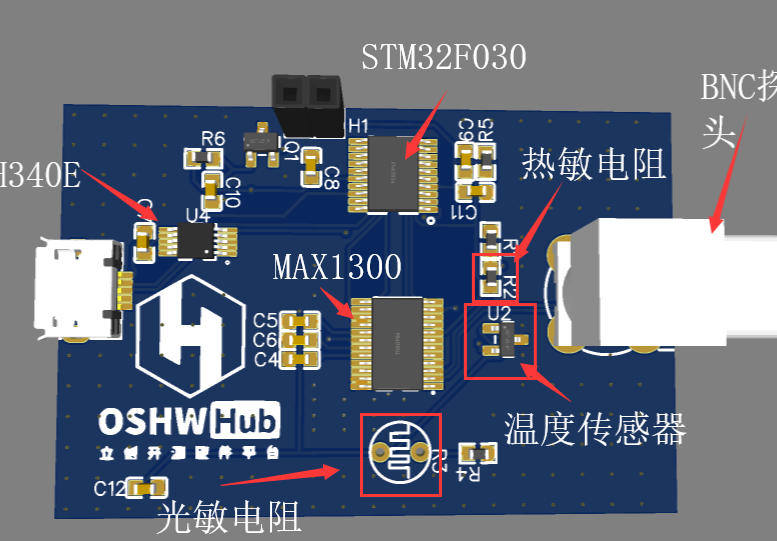

I used this chip to make a solution verification board. There is a differential input on the board (using a BNC connector to connect the oscilloscope probe).
At the same time, two simulated temperature sensors [mutual verification] and a light sensor are placed on the board.
![TIM screenshot 20200604000038.png] The board is equipped with STM32F030 and CH340E [used to communicate with the upper computer software].
