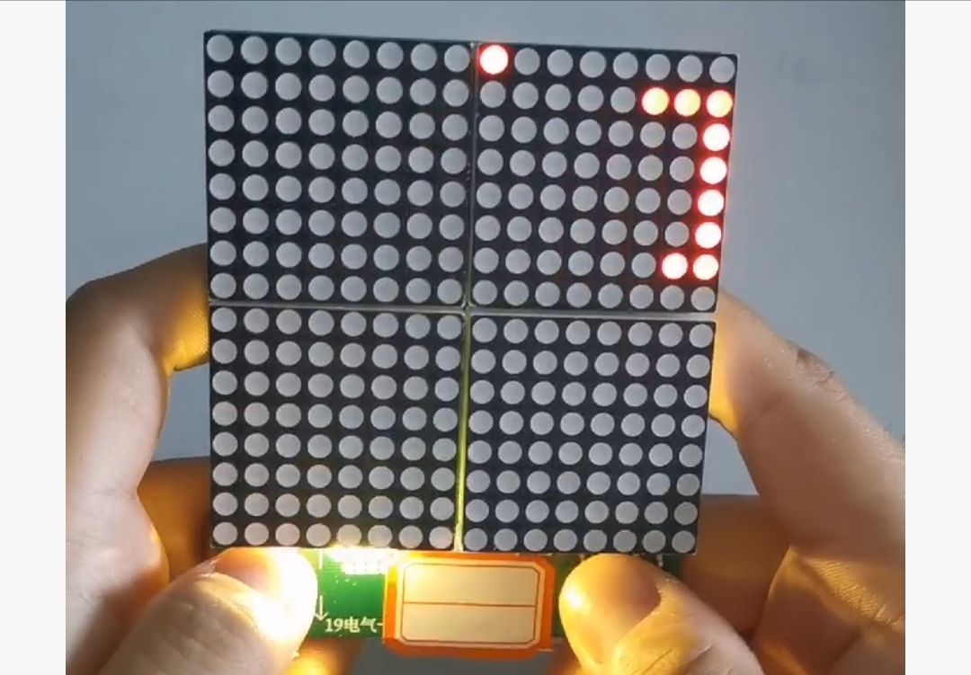

Snake design based on microcontroller
      Summary
This design is a Snake game system with a microcontroller as the control core. The designed greedy snake can control its up, down, left and right movements, eat food and automatically place food with four buttons. After the game starts, there will be two sections of the snake body and one piece of food by default. When the snake eats the food, the snake body will automatically lengthen. The hardware design includes four 16*16 dot matrix composed of 8*8 dot matrix and its driving circuit, independent buttons, lithium battery charging and discharging circuit and download circuit. The software is programmed in C language, which is convenient and flexible, greatly speeding up software development, shortening the development cycle, and making it easy to transplant. The designed Snake game system is lightweight, portable, suitable for all ages, has low cost, and has certain market prospects.
Keywords : 51 microcontroller , dot matrix , game, snake

单片机复位后,单片机运行main()函数,初始化定时器并点亮由两个LED构成的蛇身和一个食物,蛇开始默认向左运动。初始化完成后单片机循环执行点阵扫描函数(点阵显示扫描函数)与按键扫描函数(检测按键是否被按下)。
Dot matrix scan function: The display principle of dot matrix is ​​to display only one line of data at each moment, and then display each line in turn, and continuously refresh it at a very fast speed, which produces a static display effect. In this design, the P2.0-P2.3 pins of the microcontroller control the 4~16 line decoder to control the rows of the dot matrix, and P0 and P1 control the columns of the dot matrix. When P2.0-P2.3 are 0 , 0 , 0 , 0 respectively , the first row of the dot matrix is ​​selected, and its display content is controlled by P0 and P1 . When the IO port is high level, the corresponding LED point on the dot matrix On the contrary, if it is low level, it will not light up. When P0 and P1 are 0xff and 0x00 respectively , the eight left LEDs in the first row will light up and the right eight will go out. When P2.0-P2.3 are 0 , 0 , 0 , and 1 respectively , the second row of the dot matrix is ​​selected, and so on to achieve the display of each row of the dot matrix. Control the P2.0-P2.3 pins to select rows 1-16 , cycle through them, and send data through P0 and P1 to display the entire dot matrix.
Button scan function: In this design, the buttons use P3.2-P3.5 of the microcontroller . There is a pull-up inside the microcontroller, so when the button is not pressed, the button input is high level, and the other end of the button is grounded. The input is low when the button is pressed. Therefore, the loop scans whether the button has become low level. When the input reaches low
