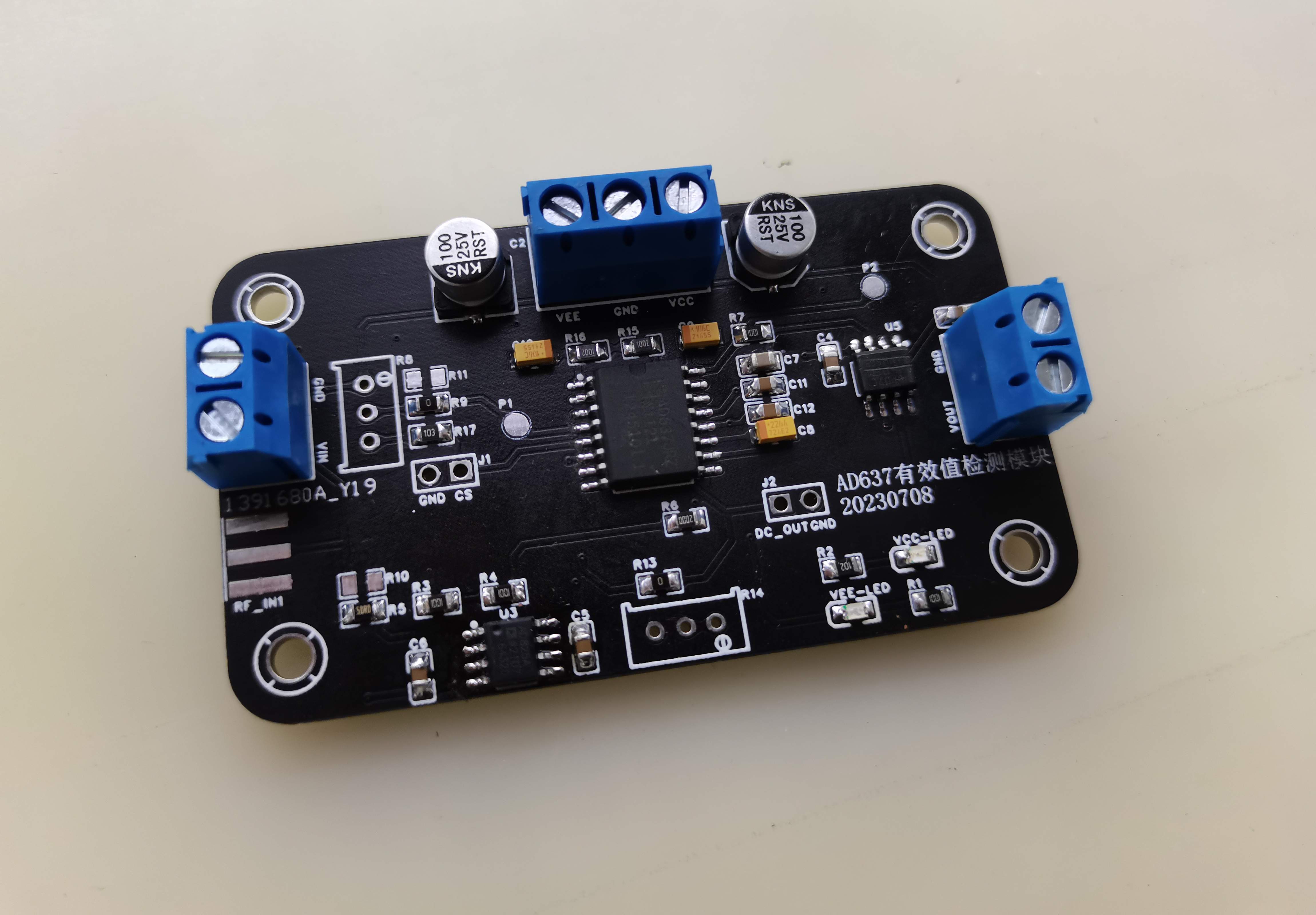

# 1 Introduction to the module
The function of this module is to convert the effective value of the externally input AC signal into a DC signal output, and can calculate the true effective value of various complex waveforms. The measurable effective value of the input signal can be as high as 7V. For a 1Vrms signal, its -3dB bandwidth is 8MHz. In addition, AD637 can reduce the quiescent current from 2.2mA to 350uA through the chip select (CS) pin. Therefore, it has a wide range of applications in data collection and instrumentation.
AD637 effective value detection module physical picture
! [a4c34333cb93fd63a1fe82cf4775564.jpg] # 2 Module usage
## 2.1 Module characteristics
(1) Wide power supply range: 5V~15V: Wide measurement range: 0~7Vrms.
When +5V power supply, enter the effective value Voltage range: 0~1.4Vrms;
when +12V~±15V power supply, input effective voltage range: 0~7Vrms.
(2) Can measure direct current signals (DC) and alternating current signals (AC).
(3) Maximum measurement accuracy: <1%.
(4) Fast response speed, the slowest response speed measured: <200ms.
(5) Maximum 3dB bandwidth: 8MHz.
(6) The output DC voltage ripple is small: less than 2mV
(7) The module input has an operational amplifier buffer, so the module input impedance is high: 1M; the module is output by an operational amplifier buffer, so the module has a strong load capacity: 10022 ~ +∞.
(8) The input and output interface is flexible and uses two interfaces, one is a terminal interface and the other is an SMA interface.
(9) It has a chip select function: power consumption can be reduced by controlling the chip select pin. The default chip select on the board is valid. Reserved (not soldered) pin interface for chip select control: reserved output voltage effective value calibration function: manual adjustment of potentiometer calibration. Since the on-board circuit design ensures measurement accuracy, the potentiometer is not soldered by default.
( 10) Module size: 70mm×40mm.
