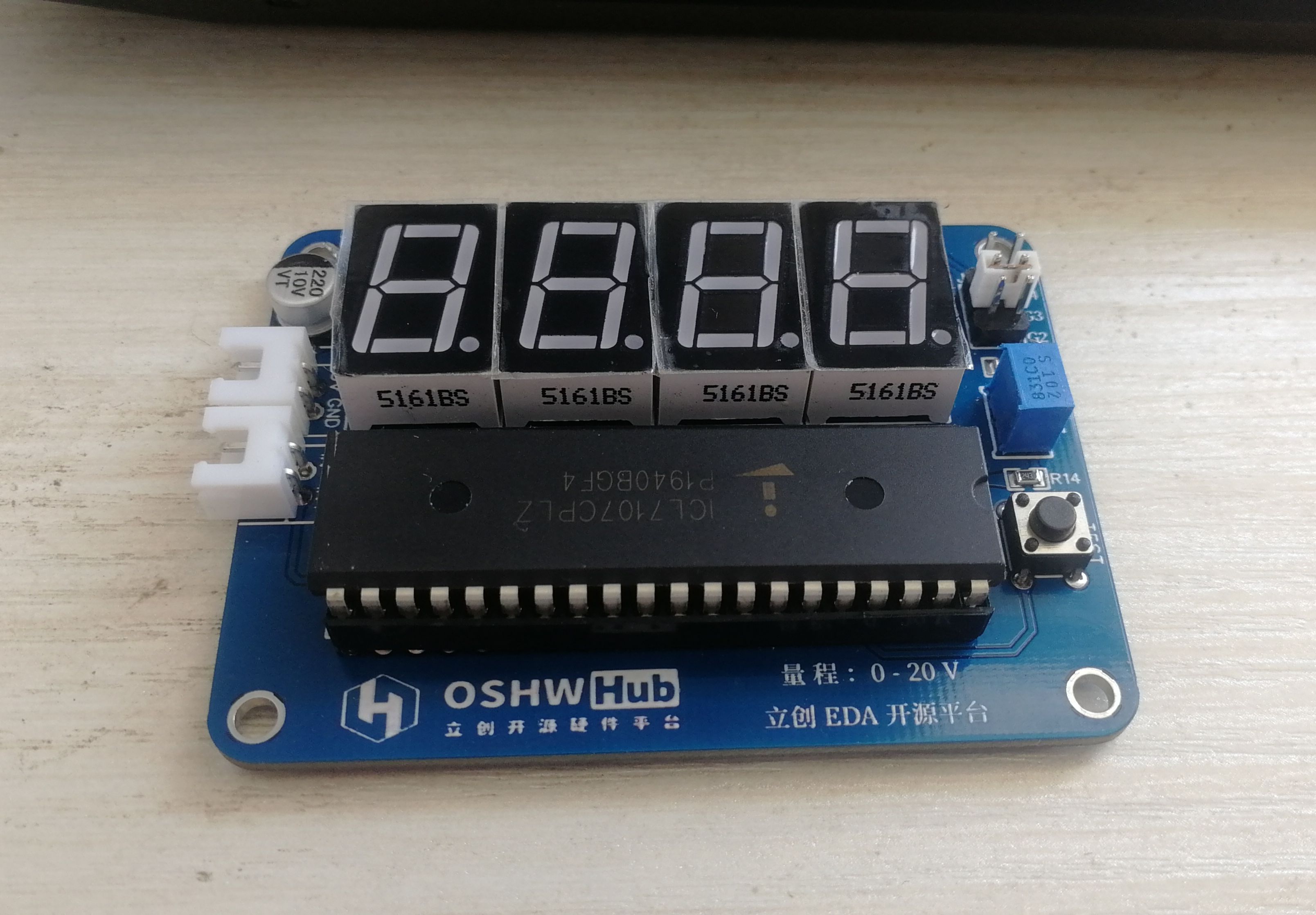

  • This design is a voltmeter based on the analog-to-digital conversion chip ICL7107
  • ICL7107 is an analog-to-digital conversion chip with high precision; segment code output can directly drive the digital tube without any program.
  • This project mainly includes ICL7107 drive circuit, four common anode digital tube circuits, etc.
  • 5V power supply, the voltage to be measured is connected through another terminal
  • When using it for the first time, you need to confirm the position of the decimal point. You only need to determine the position of the jumper cap. The adjustable resistor is used to accurately adjust the display of the digital tube against the voltmeter. The button is a test function. When pressed, the display is displayed. All will be cleared
