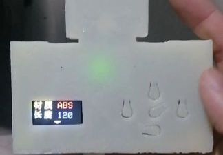

The project has verified that
when welding spring probes on the top three pin headers,
pay attention to the screen welding direction.
If the screen display is abnormal, do not solder ams1117. Short-circuit 5v and 3v3 at the pad position of ams1117
when welding the D5 pin of arduino nano. Short the D7 pin and
select the 0.96-inch st7735 for the screen.
Please message me privately for the 13pin screen firmware and shell 3D file, or comment that
I have finished products for sale on Xianyu, but this product is strictly prohibited for commercial use without authorization.
