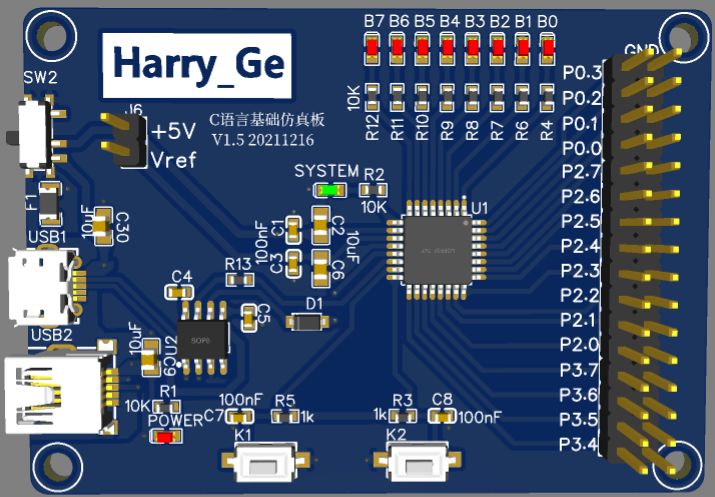

CH340USB to TTL, plug and play
STC8G2K32S4, supports simulation
Eight-digit LED is also used to display program status
Lead out other empty pins to prepare peripherals
In addition, lead out Vref (ADC reference voltage), which can be used to play with the on-chip ADC. In fact, it is of no use. Generally, it is connected to 5V. It is OK to insert a short-circuit cap or wrap a wire.
