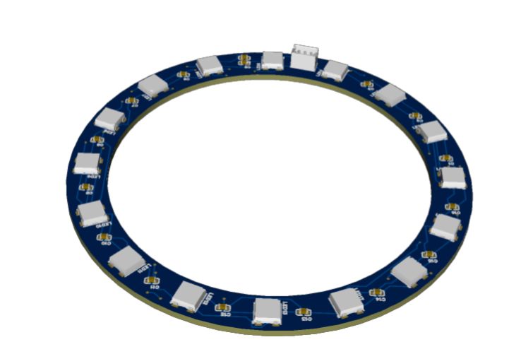

led color light ring
It's just an ordinary light ring. Try not to look directly at the LED light source. This LED is very bright, so be careful to protect your eyes. ZH1.5 straight pin, 3P interface. Just search for the ZH1.5 adapter pin header online. (I used the pin header when I printed it myself. I found that wiring is very troublesome. It is better to use terminal blocks.)
Looking at the front of the board, that is, the terminal surface, the pins of the terminal block from left to right are, respectively, DI, + 5V, GND)
