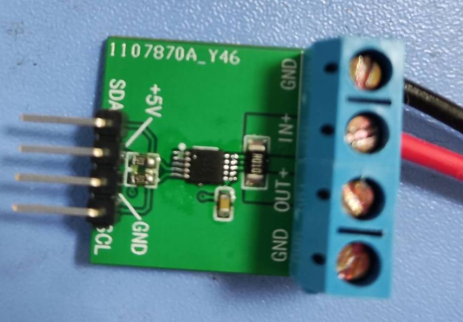

INA226 module
### Chip characteristics
1. **Measurement voltage range: 0~36V**
2. INA226 maximum acquisition stable shunt voltage: 81.92mV
3. The measurement current range depends on the resistance of the voltage dividing resistor and the maximum voltage dividing. Generally speaking, the smaller the voltage dividing resistor is, the larger the measurement current range is. For example, when using a 0.1R voltage dividing resistor, the maximum measured current is 817.2mA
4. The default shunt resistor is 5mΩ, and the maximum current that can be collected: 81.92mV/5mΩ = 16.384A
5. Chip working voltage: 2.7V~5.5V
6. Default IIC address: 0x40
### Working principle
INA makes two measurements during operation: shunt voltage and bus voltage, and then converts these measured values ​​into current according to the calibration register value to calculate power.
INA226 is a high-precision current and voltage monitor that can measure the voltage difference (Vsense) between VBUS and VIN.
The VBUS pin is used to measure the bus voltage and can be connected in the range of **0~36V**.
The VIN+ and VIN- pins are used to measure the voltage across the shunt resistor. The voltage difference between them cannot exceed **±81.92mV**.
**It will work if the VBUS pin is connected to VIN+ or VIN-, but it will be more accurate to connect it to VIN- because it can eliminate the common mode interference at both ends of the shunt resistor.
