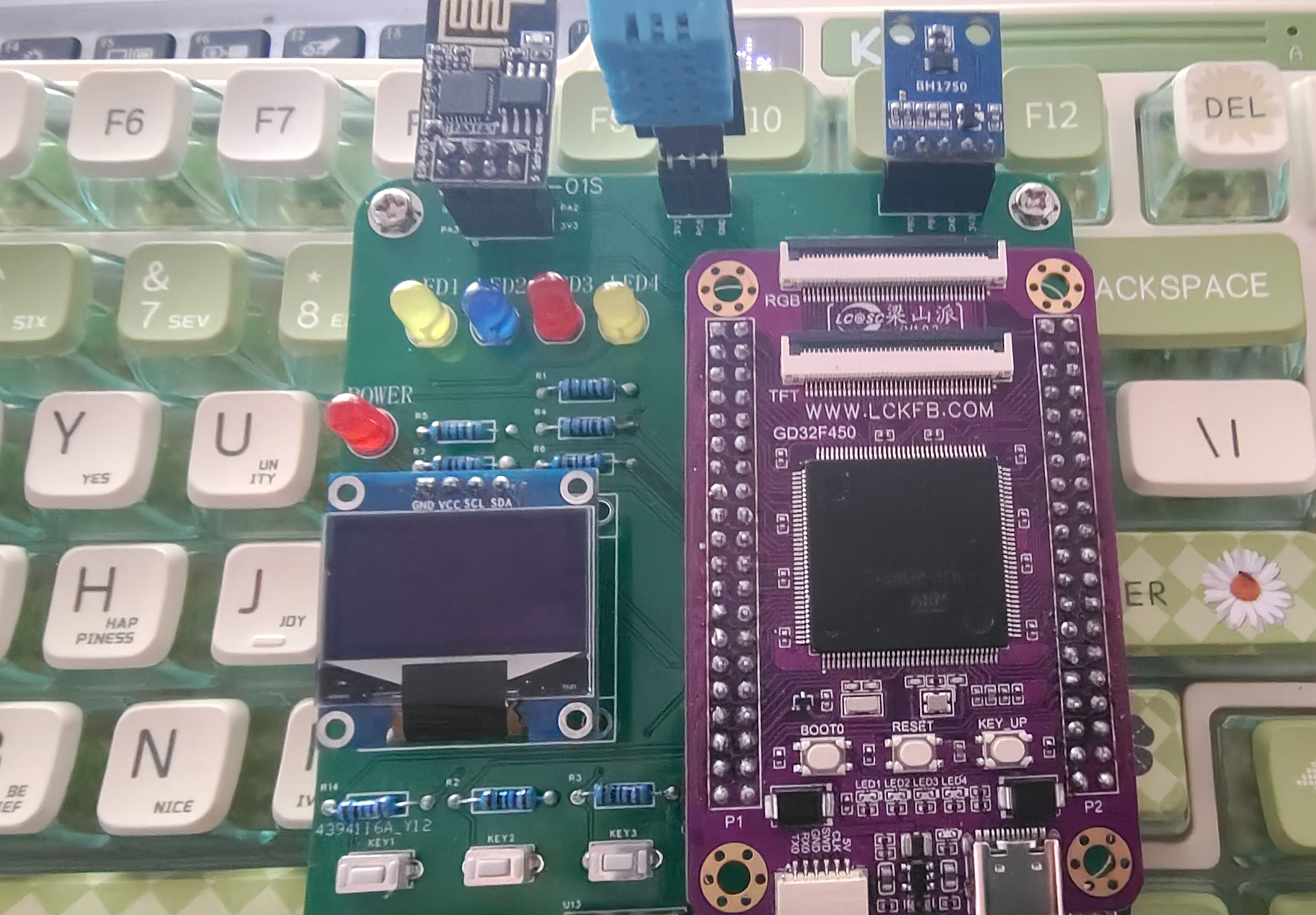

1. Objective:
To be familiar with the development process of embedded projects, master how to port STM32 code to Liangshanpai and run it smoothly, master how to connect to Alibaba Cloud through ESP8266-01S and report data, and Liangshanpai's data processing.
2. Function introduction:
·Realize the function of collecting environmental temperature, humidity and light intensity
·Realize the function of displaying the collected data on the OLED screen
·Realize the function of switching OLED screen pages by pressing buttons
·Realize the function of adjusting temperature, humidity and light intensity thresholds by pressing buttons
·Realize the function of alarming when environmental parameters exceed the set thresholds (use the lighting of LED lights to simulate alarms)

5. About code transplantation
· When transplanting STM32 code to Liangshanpai, pay attention to the main frequency of both, especially when transplanting STM32F1 series MCU.
· It is recommended to transplant the adaptation code of STM32F4 series MCU to Liangshanpai, because the main frequency difference between the two is not big, and they can be transplanted directly, and only the library files and library functions in the code need to be changed.
